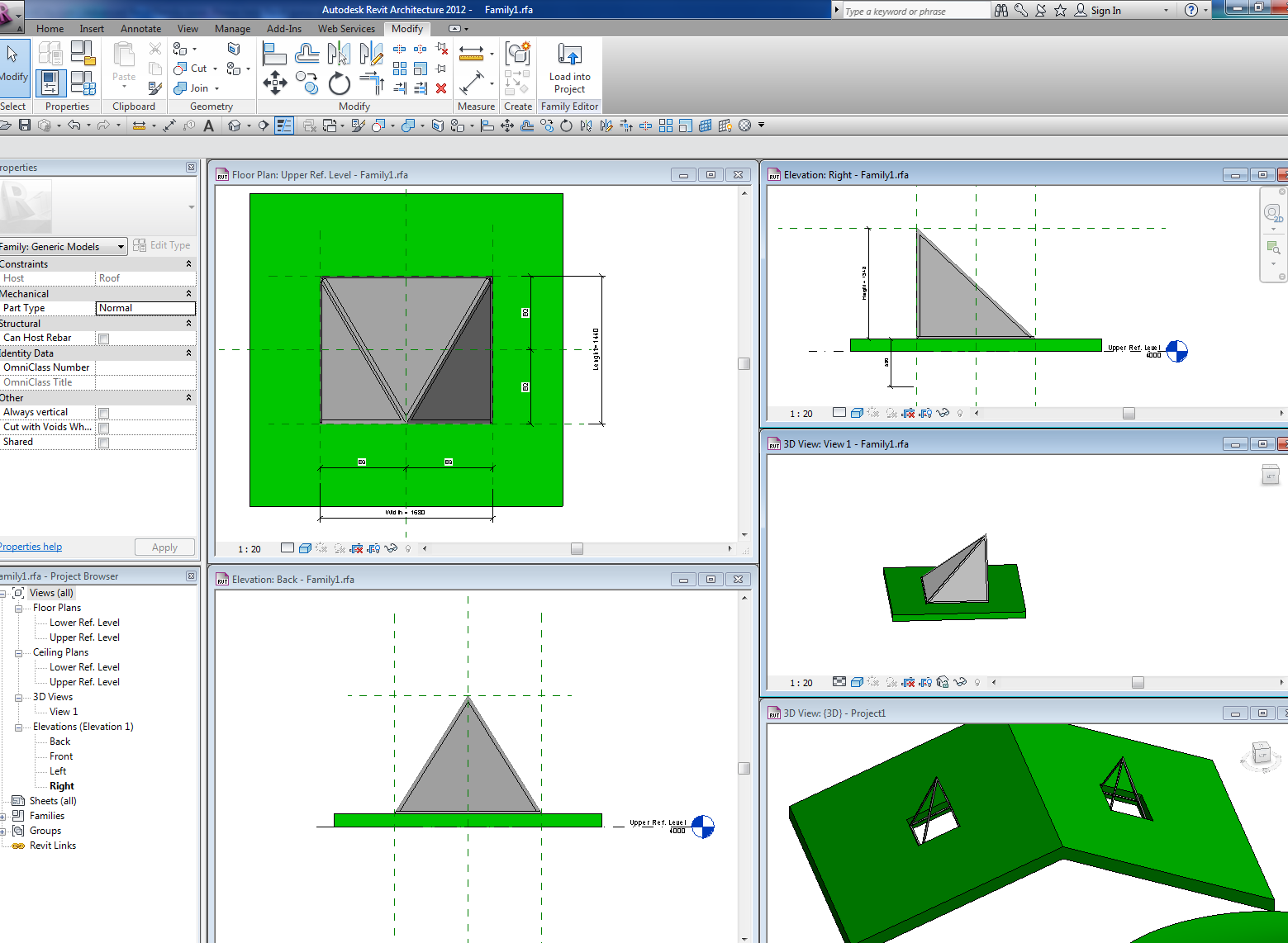

Hi All, I am facing a challenging question on how to make a sky light pyramid shape (triangles at all 4 sides and one side is 90 angle with the roof). Couple of issues I am facing when using roof based generic model family: +The void only create opening of the roof when load in to the project but I want it also to cut / create opening of the ceiling which is 6 feet below the roof level. Can I do it with roof based family ? +what is the easiest way to make the pyramid shape (triangles at all 4 sides and one side is 90 angle with the roof) ? I tried to make it with one solid and couple of voids but its really hard to control the void with some parameters(including some formula for my angle : atan(height/width))... + I am thinking also using conceptual mass to build and create some thickness for the pyramid using pattern based. My issue then the mass wont cut the roof and ceiling so everytime i change my parameter( height and width) to get my new shape , I have to update my openings in the roof and the ceilings...lots of work...what the best way to then if I want to go this road ? Thanks so much....

This is just an example, open the family and see how you can create what you want and about this: "The void only create opening of the roof when load in to the project but I want it also to cut / create opening of the ceiling which is 6 feet below the roof level" NO, you'll need to create those openings in your ceiling, roof families can't cut ceilings.

thanks Typhoon for the family. Very kind of you.
Yes I know I can create opening in the ceiling and even locked the sketch lines to the roof family opening but still alot of work. I have alot of skylights with different sizes...Some one from revit forum mentioned using solid instead of void in the family/assign yes/no paramater then load in and  join that solid with the roof and the ceiling then turn it off...will try that technique...
