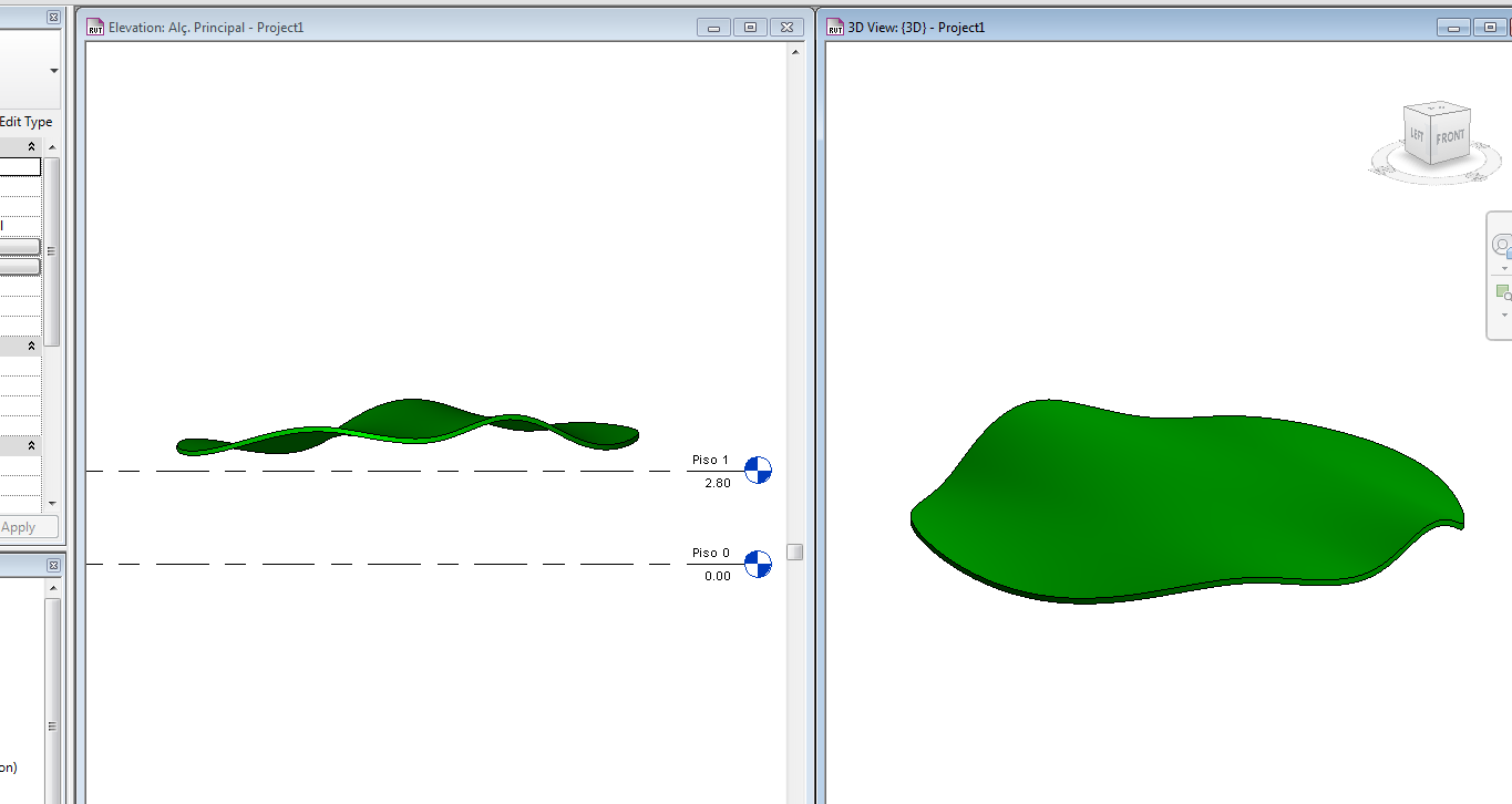

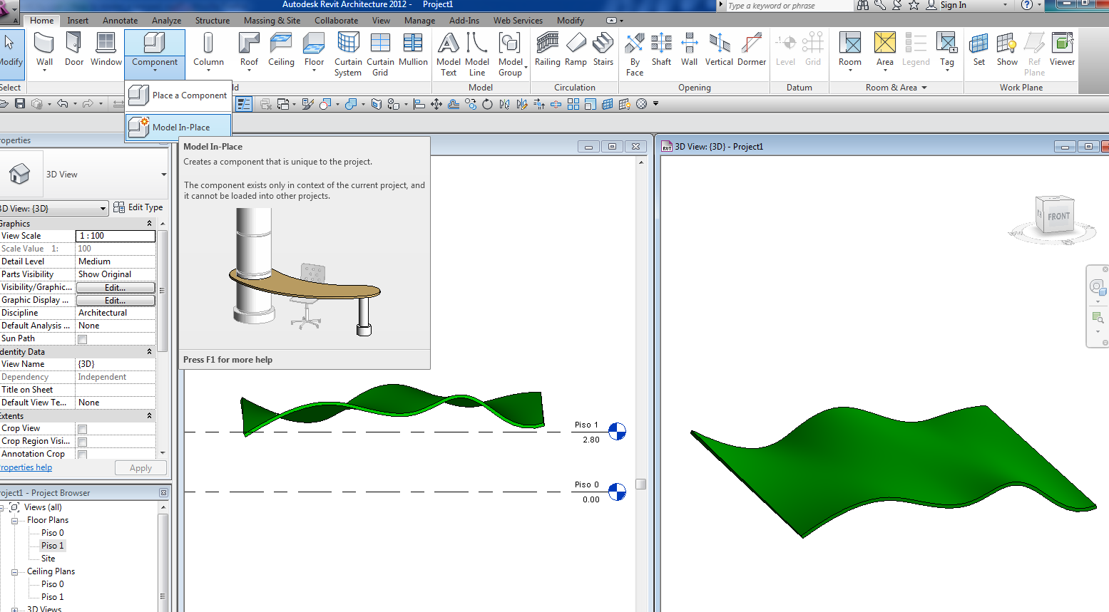

Some screen shots of what you want to do will help but you can create that with mass then apply roof by face or with "Create-in-place" in roof category, use the "Solid Blend", you can create differents blends with different materials and dif. thickness, so when you create a section view you'll see dif. layers.

Ok, watch this:  http://screencast.com/t/9Y0VvA3CEh , I create this video to other person many months ago and this is not a "Barrel Vault" it's a "Rib Vault" but the process is the same...
Hope this help
