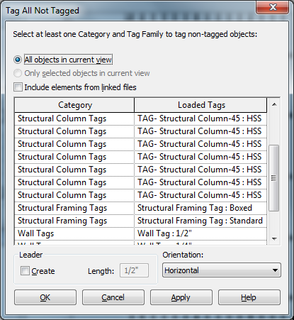

When I tag by category I can't for the life of me get it to tab to the beam system, only individual beams.  Your post gave me the idea to try to "Tag All" but when I do I don't see that Beam System tag as even being loaded.  See attachment.
Thanks.
