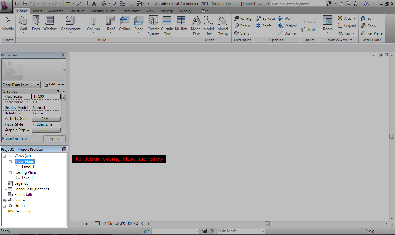

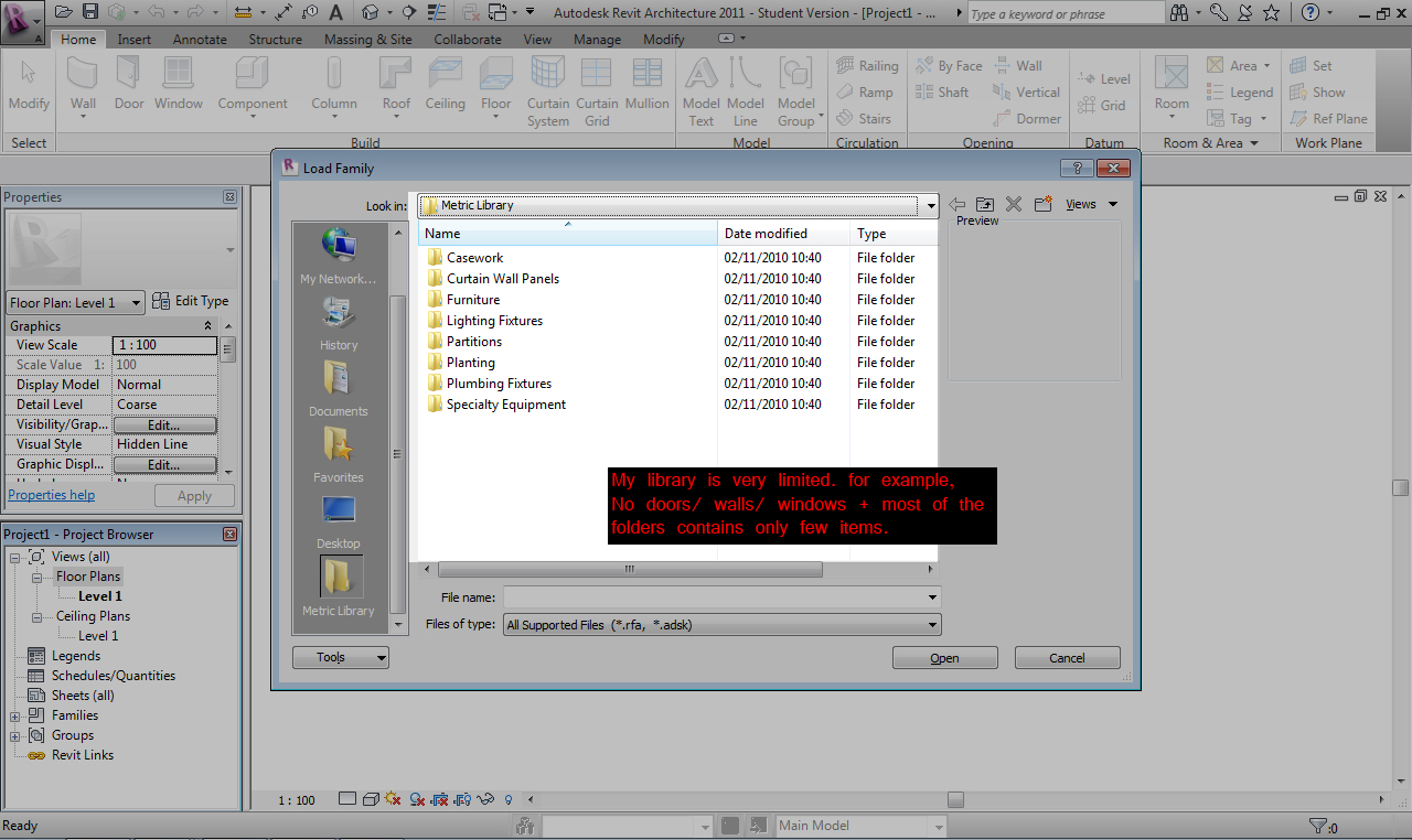

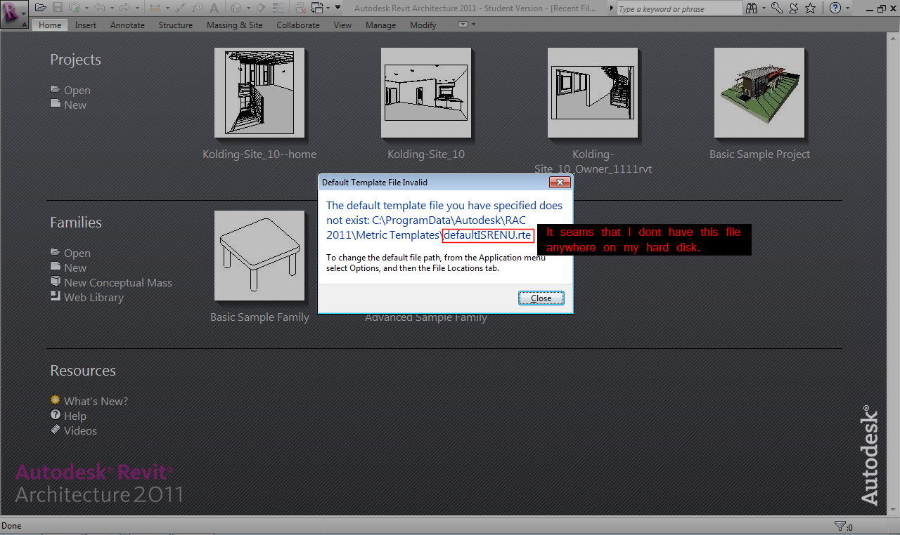

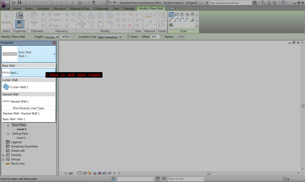

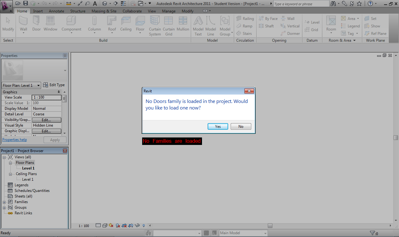

My educational version of Revit Architecture 2011 has a major problem since it was installed on my computer - basicly it seems that I've got no libraries or templates installed.
After consulting with Autodesk support member it seems that I got no other choise but to uninstall my version and download a new one from the site. Here's the issue - from the site I can only download Revit2012.
I'm pretty new to Revit and with the advice of my professor I recently bought "Mastering Revit Architecture 2011". I want to practice on the version I already started to learn.
Can I download ISRENU.rte file anywhere?
More info about my Revit problem is in the attached images. And yes, I ran a search for the file on my machine, I tried to repair and reinstall the software but none did any good.

"After consulting with Autodesk support member it seems that I got no other choise but to uninstall my version and download a new one from the site. Here's the issue - from the site I can only download Revit2012."
here you have: http://usa.autodesk.com/adsk/servlet/item?siteID=123112&id=14973244
