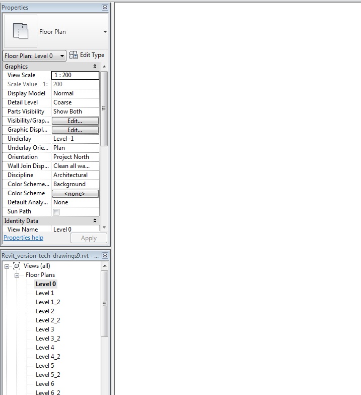

I have a problem with viewing a floorplan. It is something that suddenly just happend: the ground floor floorplan is invisible (you can enter the floorplan, but there is nothing), while all the others are fine.
I've tried to delete the floorplan view and add it again, changing de settings to default, changing the visibility and different zooms - nothing.

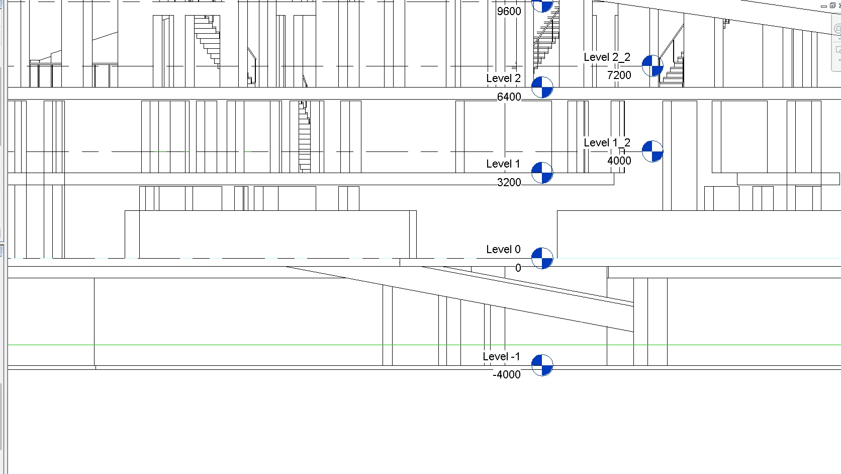

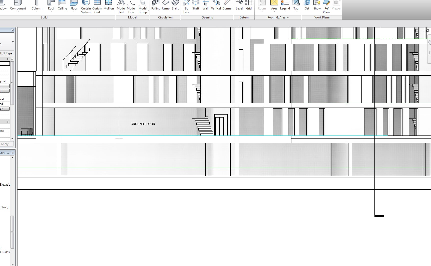

Please post a section through the building that shows the elements and the floor levels.
Fri, Jul 29, 2011 at 11:54:43 AM | Floorplan invisible
B0bTheBuilder
Joined: Fri, May 6, 2011
9 Posts
Fri, Jul 29, 2011 at 12:21:14 PM | Floorplan invisible
We need to see the floor level indicators....I want to see that the ground floor level is really at that level.  No just Notes but the level that has the eleveations of each level.

Fri, Jul 29, 2011 at 12:27:03 PM | Floorplan invisible
#9
B0bTheBuilder
9 Posts
Don't if this one helps?
Fri, Jul 29, 2011 at 12:29:55 PM | Floorplan invisible
#10
B0bTheBuilder
9 Posts
And here is the invisible floor plan..

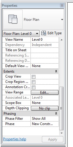

Fri, Jul 29, 2011 at 1:05:35 PM | Floorplan invisible
#11
Does your project have a scope box?
Make sure your plan view is not cropped and there is no scope boz, then zoom a.
Fri, Jul 29, 2011 at 1:47:20 PM | Floorplan invisible
#12
B0bTheBuilder
9 Posts
No scopebox - nothing.. (see picture)
