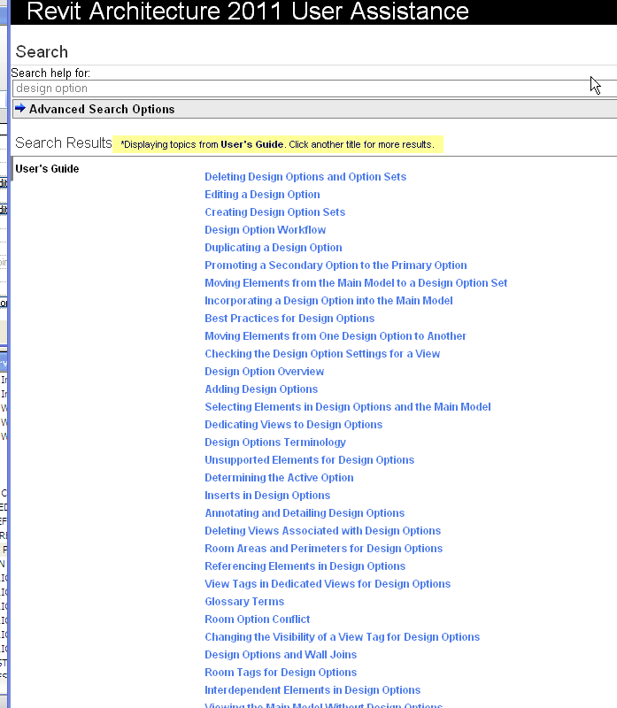

Thanks a lot for your tips. Sure I have to do more reading, though I didn´t really know what I was looking for. You mentioned “design options” but can´t find in Revit´s help menu. What I need to do is create 2 different layouts of the same building.

You said you couldn't find "design options in the Revit HELP?  Where are you looking?
Here is a snapshot of half of what is listed:  Search < Design Option >
