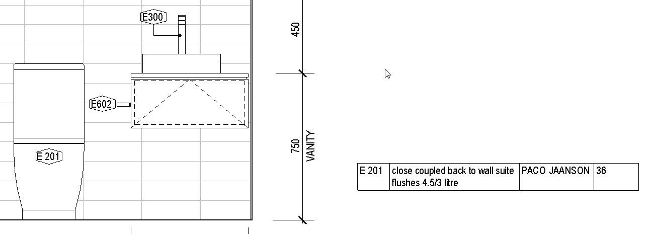

See attached for quick example the WC has a Type mark this is scheduled as is description manufacturer and quantity in the project.
