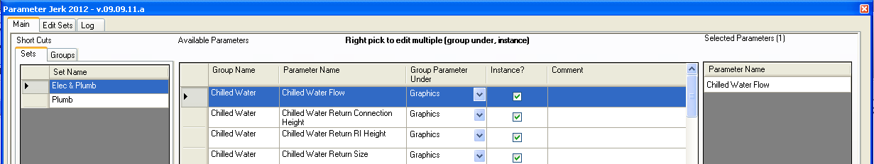

Awesome, great update! Seems to mostly be working, but I'm getting some errors when using sets.
1: When I open PJ the top set will be highlighted, but none of the params in the set will be selected. Since the top set is highlighted, clicking does nothing. I have to select a different set, then the top set (see PJError1, that's what it looks like just opening PJ, I haven't clicked anything).

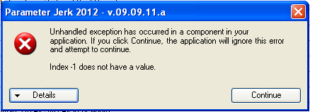

2: It's not doing it now but the first time I was using it I wsa getting an error every time I selected a set, in the Main and the Edit Sets tab (see PJError2).
