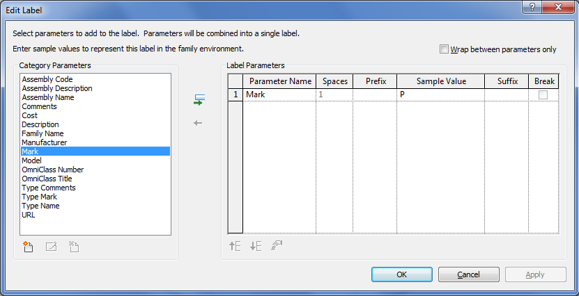

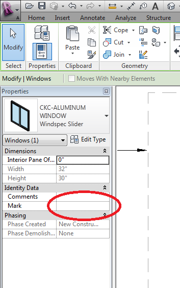

click on your window tag, hit 'edit family'. now click on the text and hit 'edit label'. I'm thinking that your tag is calling out the 'type mark', if so, remove that and add in "mark". Reload the tag family into your project. Then in your properties menu, give each window an individual Mark number.
