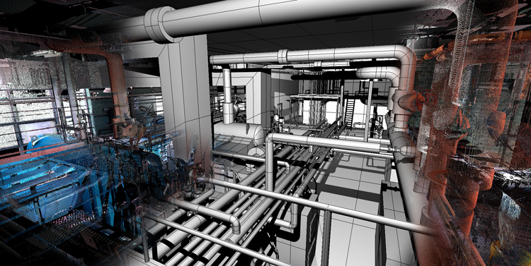

Lets say I have a dwg that is made up of pipe centerlines for an entire boiler room.  Is there an easy way to import that CAD into Revit MEP and generate pipes from the existing centerlines?
I am pretty new to Revit so any suggestions would be appreciated.
I can get the linework imported but when trying to snap to the line endpoints it projects my selection to the nearest level.
Id ultimately like to be able to go to a 3D view and just create pipes by snapping to the existing dwg centerlines.

No the CAD is deffinetly in 3D.  I built it in another software package.
I am just trying to teach myself to create a Revit native model using the existing linework.
I have attached a shot of the room which I have already modeled elsewhere.
