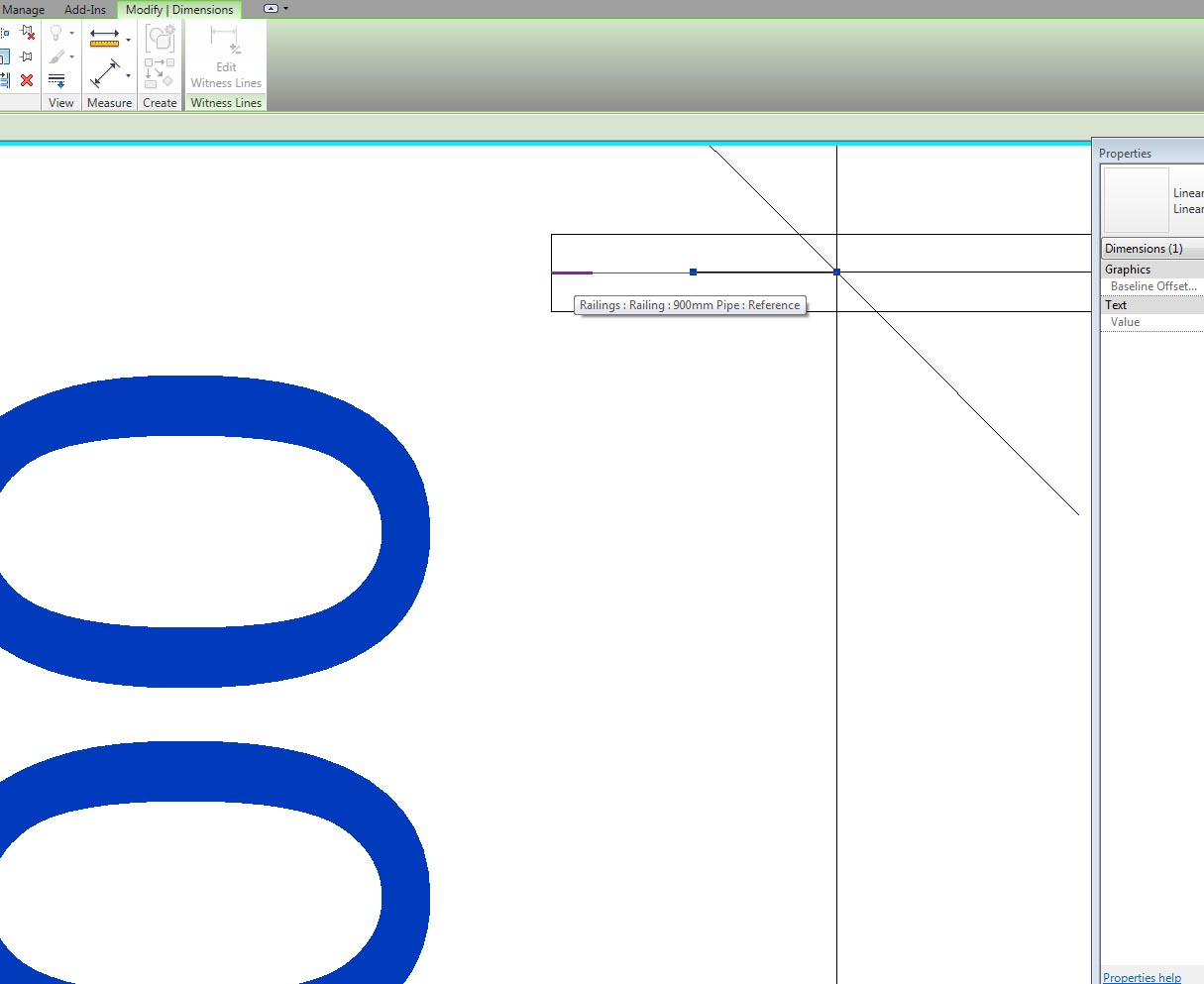

Hmm, that's sort of a hassle. But you can still find a centerline if you dimension to the ends of the railings. At every join and end condition you'll find a little centerline segment you can dimension to in plan.

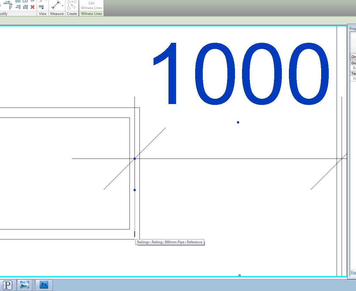

I don't know what to say.. I'm using the sample project you linked, and your latest railing profile. Maybe try isolating the railing for a sec, or tabbing through to see if it brings up the centerline? Stronger references might be nearby, like edge of stair?
pic of end condition seeing reference
Edit: wireframe does make it easier to select.
Edited on: Fri, Jul 1, 2011 at 4:27:31 PM
