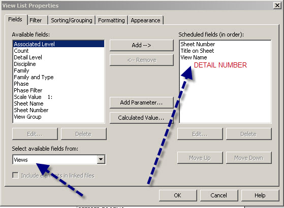

I'm trying to clean up my project using a VIEW LIST PROPERTIES.  Is there a way to add a column that shows me where my detail is placed in the project sheets.  This would really help me with coordinating view quickly.  VIEW ATTACHMENT

Under schedules you will find a view list.  This will tell you what sheet each view is on if placed.   It is not set to tell you which view number and there appears to be no way to get that.
