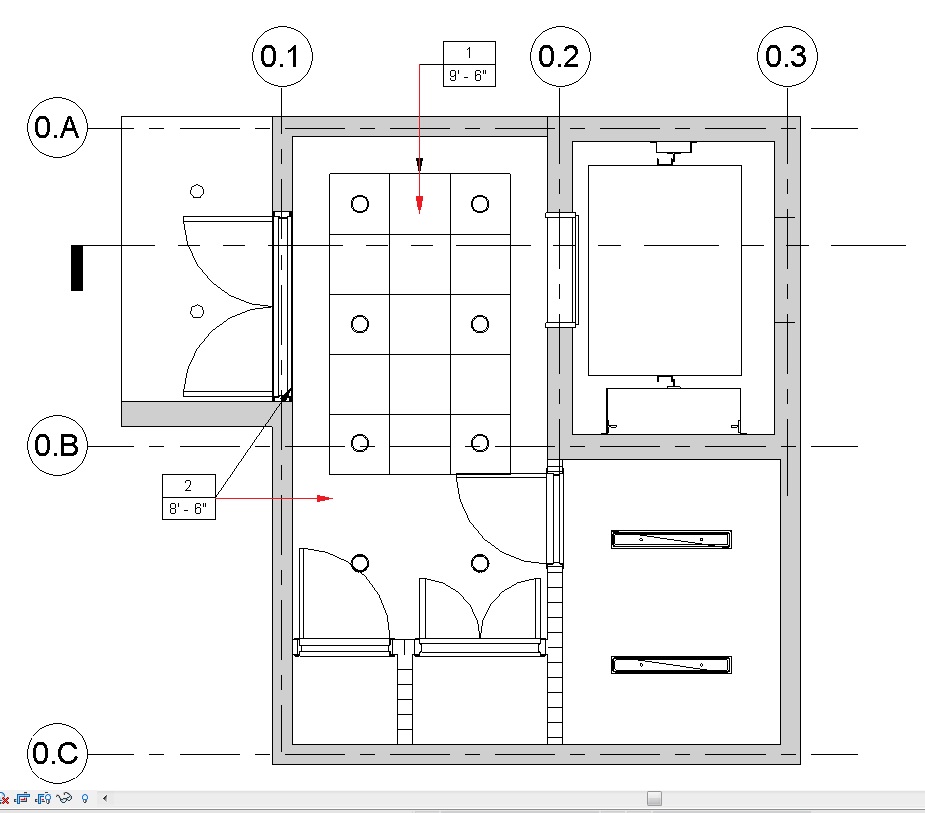

Its Possible to change the location of where the leader points in a ceiling tag? I would like it to point to the surface of the ceiling rather than the boundary of the ceiling. The attached document explains it (the red arrows is where i would like the tag to point at.
Thanks for any help.

With the tag selected try changing the leader from Attached End to Free End on the options bar. I'm assuming you can do that with a ceiling tag, I don't use them but it works for the other types of tags I use.

Ditto.

Works Perfectly,
Thanks a lot.
