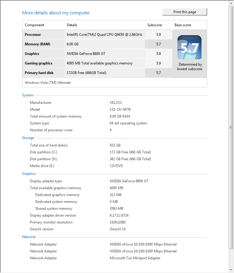

Take a look at the above rendering times are connected largely to processor speed. If you are not doing a great amount of rendering then it becomes less important. See the attached Computer Speed Index, to give you an idea. I don 't do a lot of rendering so this computer seems to work fine for me. However renderings take hours, for pretty much everyone.
