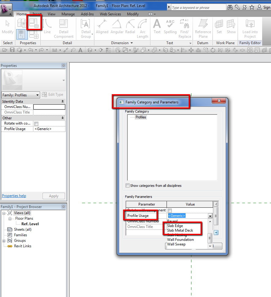

You can create any profile you want, just go to File > new > Family, choose "Metric/Imperial Prodile" then in "Family category and parameters" change the profile usage like you want.
Thu, Jun 23, 2011 at 7:01:36 AM | Resident Profiles within the project...cant locate and edit them
Floors don't use profiles.  Do you mean slab edge profile?  All profiles are in your browser under the families - profile category.
