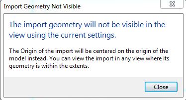

I have found a fix. When in a section/elevation view -
 1. Link the CAD-file, but do not check the "current view only" radio-button.
 2. After importing, the view is still missing the linked cad-file, but you get this message:
 3. Now go to a plan view, and uncheck all the cropping-radio-buttons in the properties-browser.
 4. Find the missing link (!), it should be located somewhere about 20-30m away from the section/elevation inwhich it
was inserted. Move it right in front of the view.
 5. Voila.
