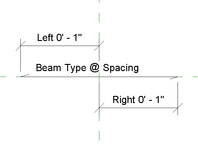

I want to be able to apply a tag to a beam system, indicating member size and spacing. I've loaded a tag from the Revit Library, but it doesn't seem to recognise a beam system as tagable. Beam System visibility is turned on, and as usual, is only visible when pre-selected. I would greatly appreciate some advice in this regard, Thanks, Martin

I can tag the beam system... Well the individual elements of the beam system. I don't beleive you can tag the beam system itself.

This is the generic "structural beam system tag" that installs with Revit. Sam Spencer Auburn, CA

The Beam System Tag is only available in Revit Structure.   The Drafting tab in 2009 Revit Structure looks like:

well that's just depressing.  so much for doing nice, clean, easily reviseable framing plans in RAC.  thanks for the info though.
