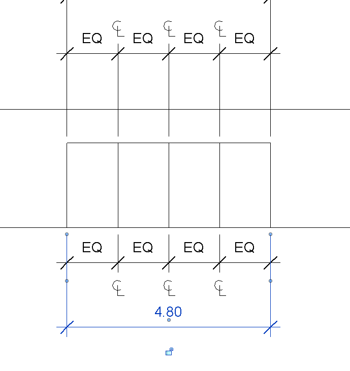

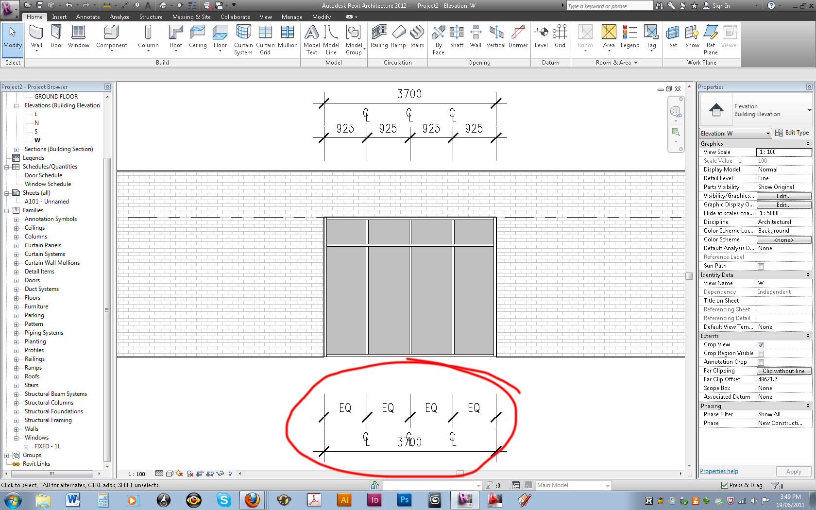

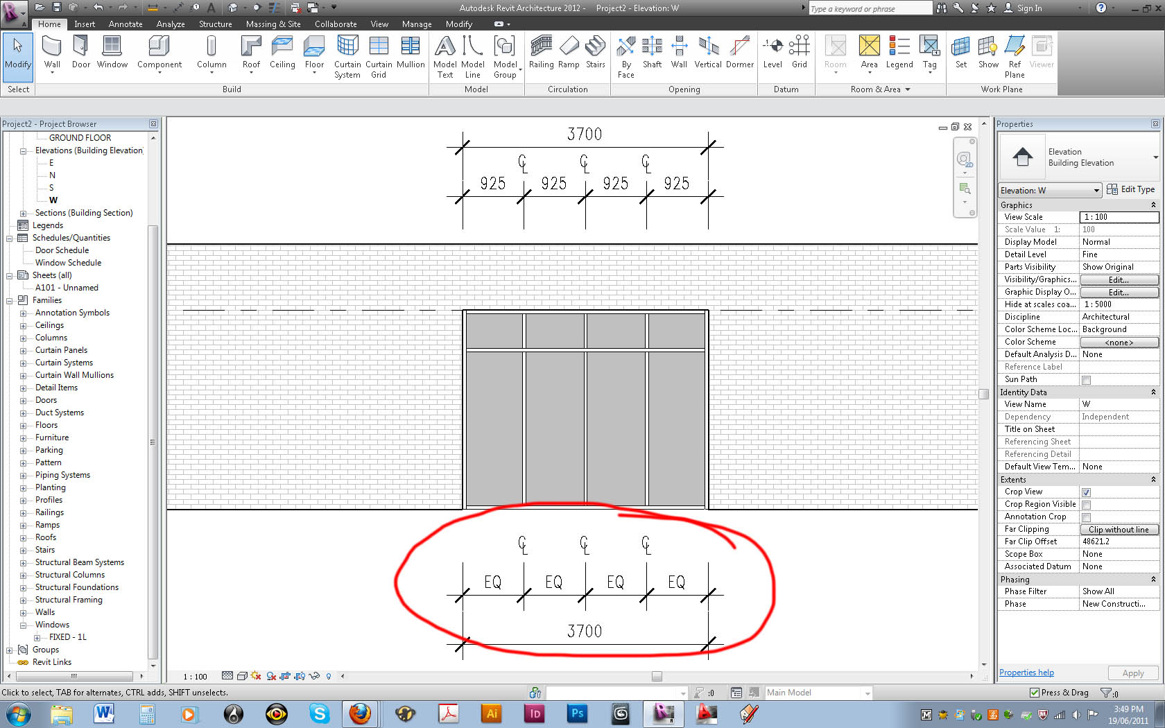

I'm having issues with the CL symbol to my dimensions flipping sides depending on which side they're placed on.I understand why revit is doing this but the symbols are covering the numeric value of the dimension below and i can't seem to move them. I've attached a couple of images outlining the problem and desired result. If anyone has a fix it would be greatly appreciated.

Just select the "Dimension line" and drag it like you want

Hmmm maybe I wasn't clear. I was trying to maintain the vertical spacing between dimensions, so the CL symbol itself needs to move. I’m finicky about things like this. I managed a work around by adding a higher CL to the tag family with on/off parameters, and then created a second dim style. It’s sloppy but it works. Still if anyone has a better solution I’d like to hear it.
