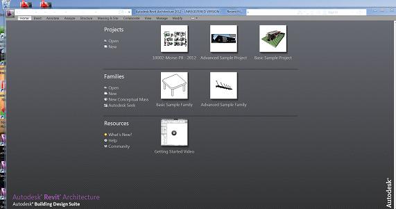

Has anyone seen this before and have a solution?  I just installed Revit 2012 on a new Dell M6600 laptop with an nVidia Quadro 400M (hoping it isn;t the graphics card, but it is too new to have been approved my Autodesk, apparently).  Windows 7 64 Bit.  The quick access toolbar and help/online toolbar (above the ribbon) do not display correctly.  I can move the QAT to below the ribbon and it's fine, but I don;t want it there and I don;t see an option to move the other bar down, so the problem still exists.  Thanks for looking.
What I tried:
Turning off the transparency setting in Windows (made it worse)
Changing color of window borders (this was the best of the colors)
Running in compatibility mode for Vista.  No change.

Typhoon...thanks for the help.  I tried on chrome and internet explorer on the new computer and chrome on the old.  Maybe the maximum file size changed?  Anyway...after all that, I went back into Windows 7 settings and changed the the theme to windows 7 classic.  It had been on an Aero theme.  That was the fix.
