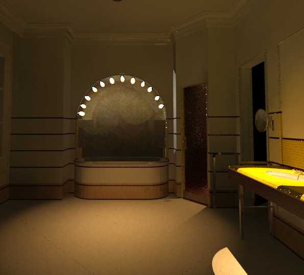

I need to create a small lighting strip to backlight a curved wall in a bathroom - as you can see in the render attached, i tried to do it creating a semi-circle of spotlights, but they are aren't exactly subtle!! The light effect on the wall is right, but not the big yellow blobs - any ideas of what I could do?

Thanks for responses - wondering how to create my own strip of lighting that are small LED type lights - currently I have been adapting spotlights which are too large.....just need a simple curved strip of small lights...can't see any on the Tivoli website thanks for that though interesting stuff

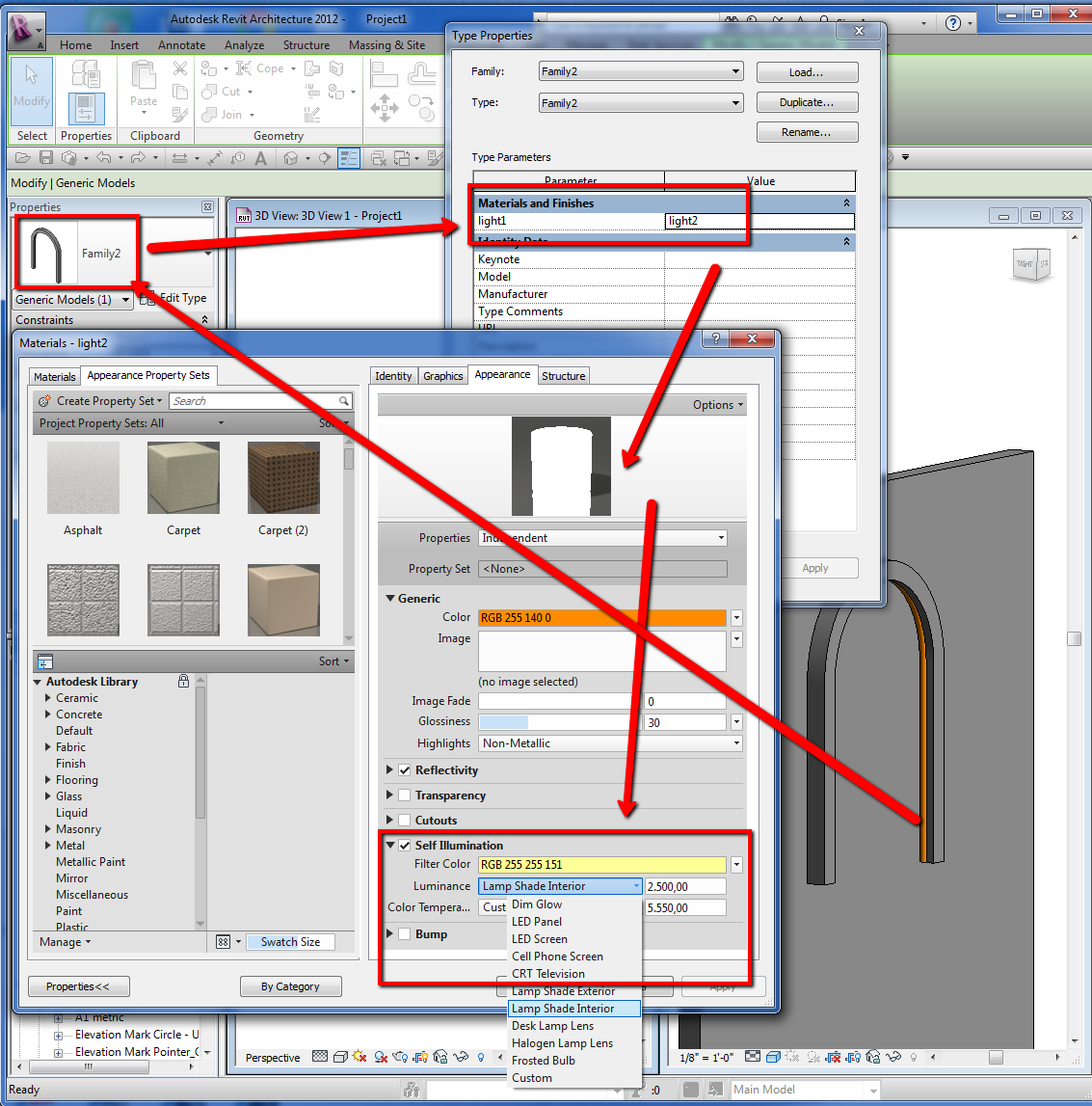

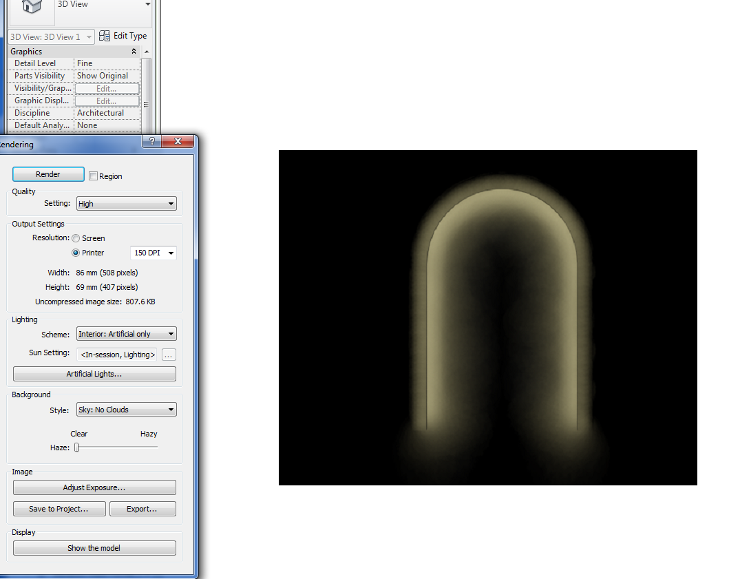

Create a new family "Wall based", then you need to create a "material" with the same characteristics of a "light", then you can play with those parameters like you want, this is a workaroud because you can't create a "Linear (curved) light" family (yet).
Hope this help
