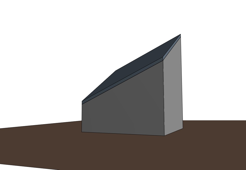

does anyone know how to form a Shed roof that can also be sloped perpendicular to the slope?  I am currently designing a home and have an entry roof that will be a 3/12 shed roof from rright to left but I also want to take that roof and ptich it at a 2/12 from front to back.  See image for clarity. any input would be greatly appreciated.

is not how to make a shed at 3/12, its taking that roof at 3/12 and also sloping the whole thing at 2/12 from perpendicular edge.

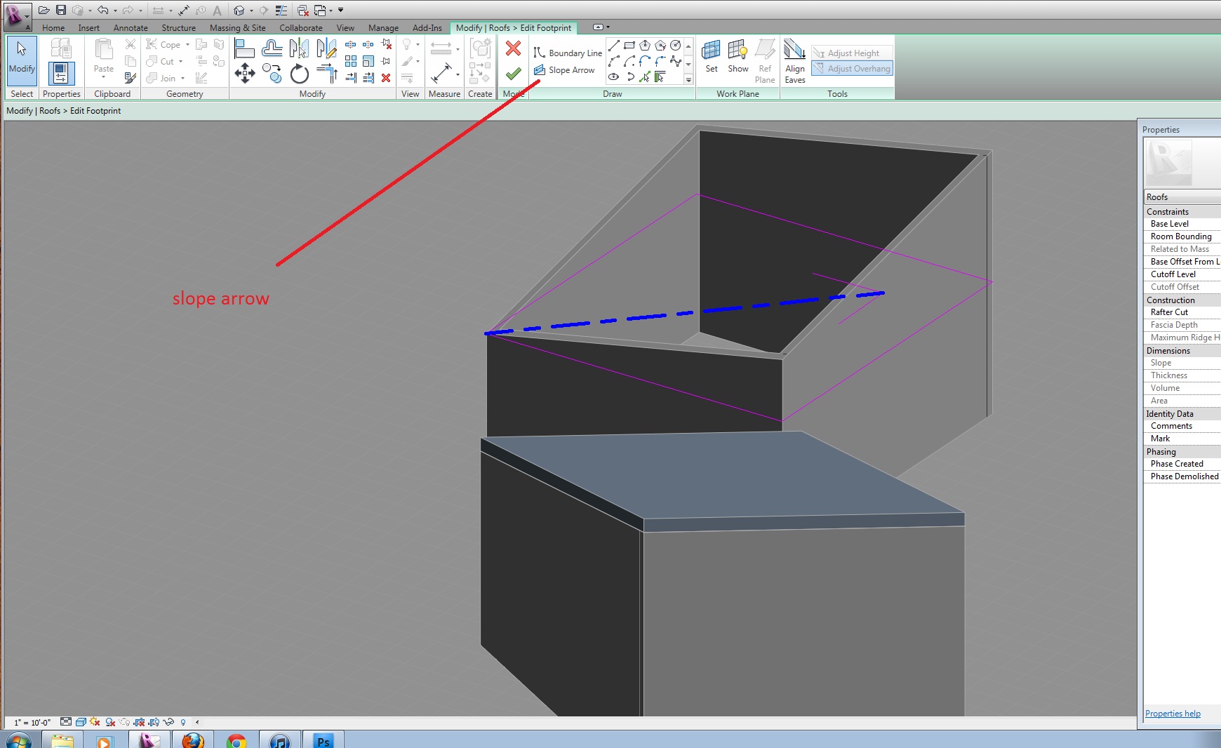

you can draw a custom roof slope -- not just the boundary lines being used to define slope.
You can also -- after you make a roof with no slope--control it with ridge lines and points.  Less accurate for slopes, more precise for your vision if it's difficult geometry.

so in your image of the roof is that sloping both directions? wont a ridge deliniation line create just that a ridge in the middle of my shed roof?

I thought you meant a flat roof which slopes from corner to corner, more or less.

yep thats the one or really close to what i have sketched and planned. thanks!
