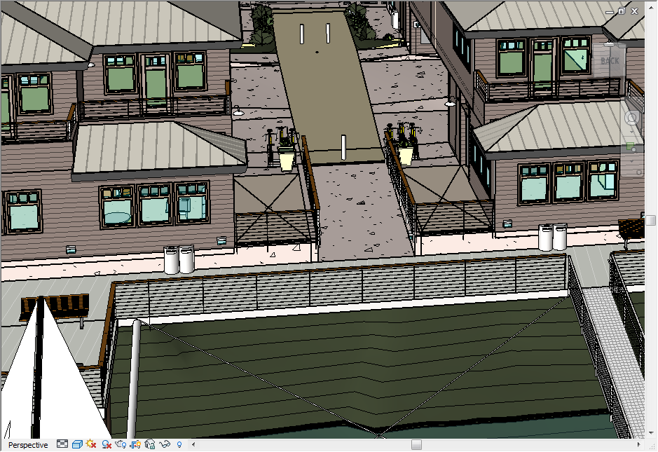

Hi every one, I'm drawing an house in revit 2011 for a customer, a great house. He desire to have metal roof somewhere, I can make it with out problem, but the final result its a disaster. The problem is that its a 3 sloped roof and in the corner, the panels doesnt follow the otherside. I post a picture of what I try to explain because english its not my first language.

I don't know what you are doing for your roof.  I do a flat panel roof and add seperate extrusions for the standing seams.  You can also just use a material but it doesn't have enough "bump" fo me, that's why I add the seams.

This view is using the standard roof from Revit City as I remember.

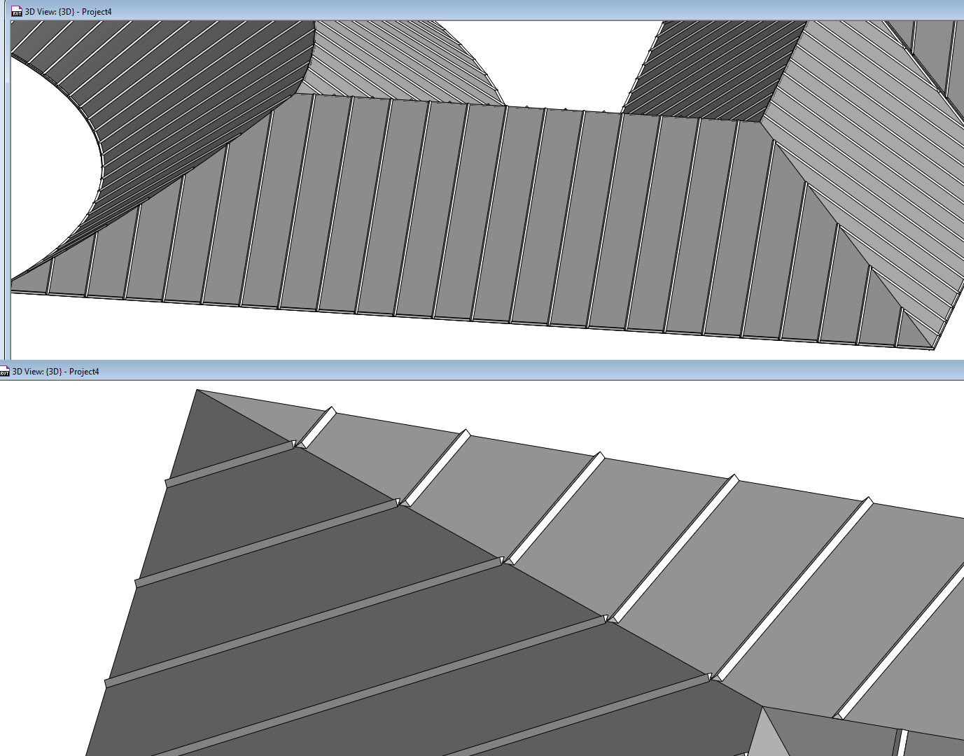

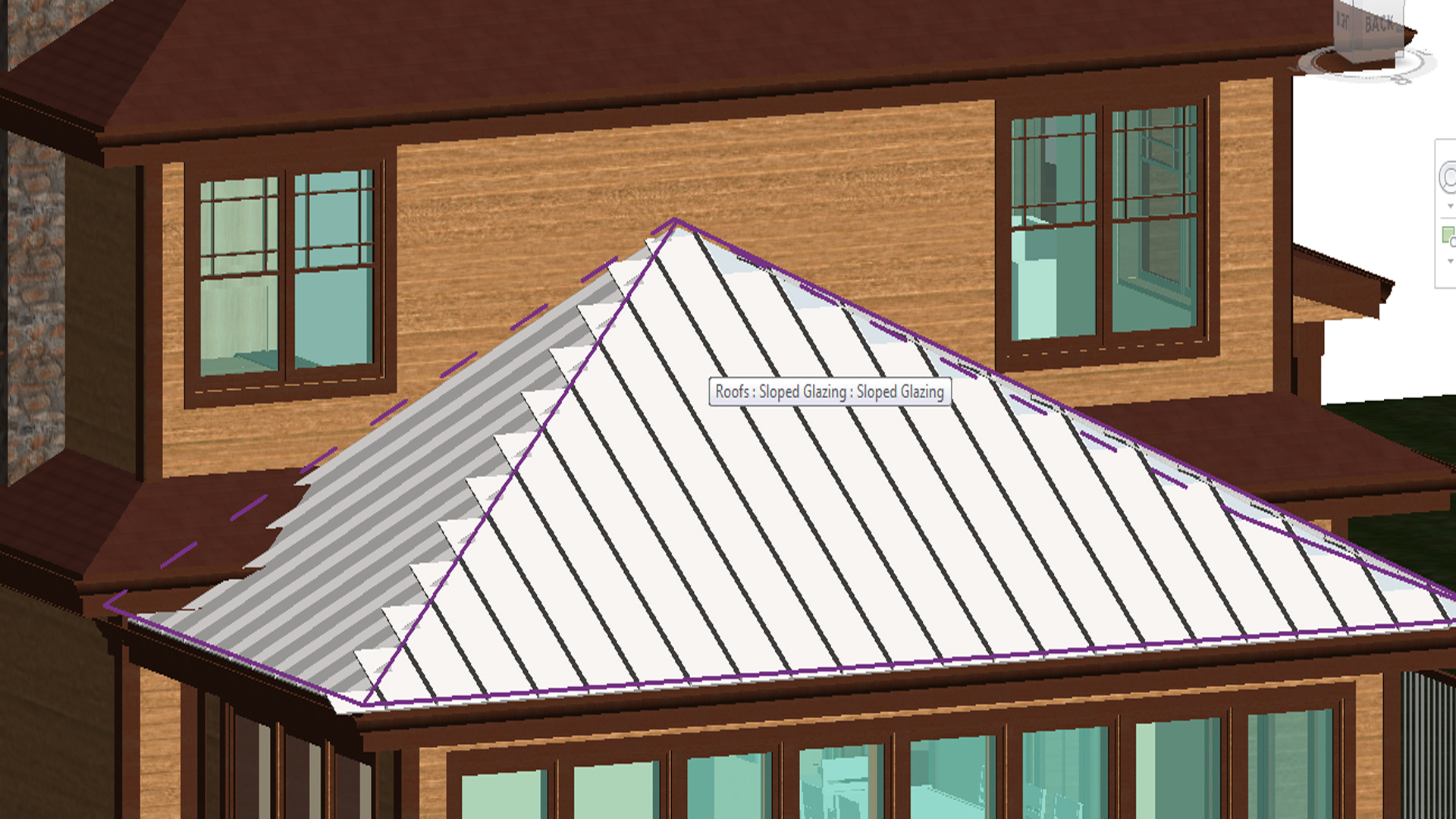

Well, I don't know if anyone else would suggest something like this... but if you use trianglular mullions that mimick the panel overlaps... and regular system panels that can conform to a diagonal edge like that, you might get something that looks pretty sharp.  I tried it out, pic related.

Ok thanks itsmyalterego. Now you got the mission to explain me how to do something like yours.
