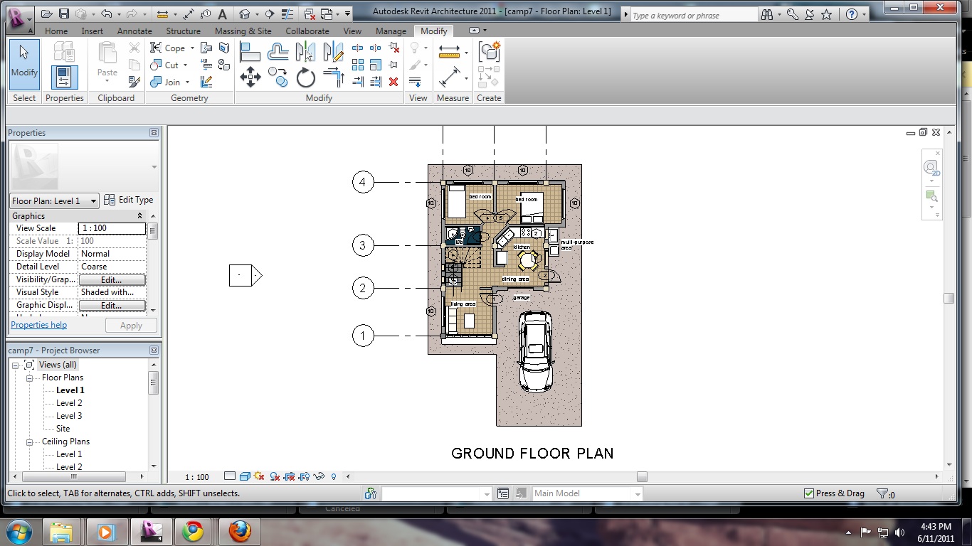

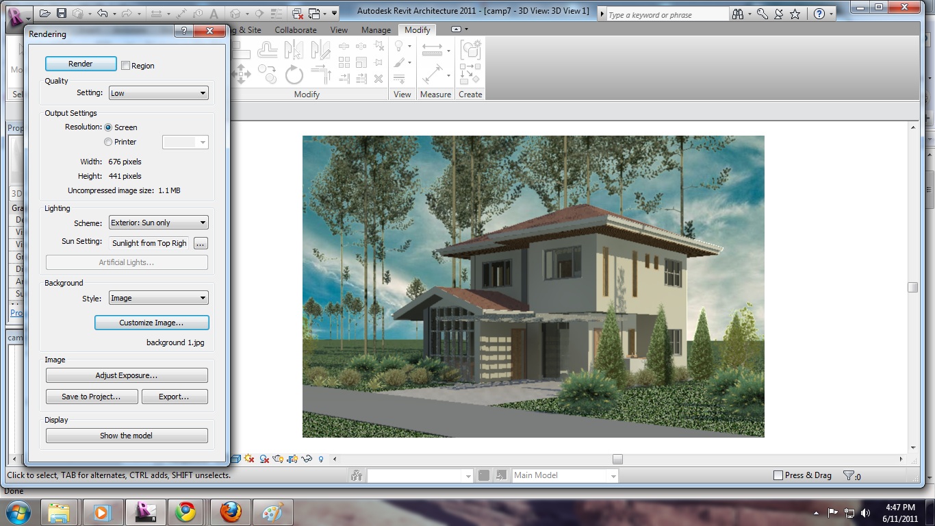

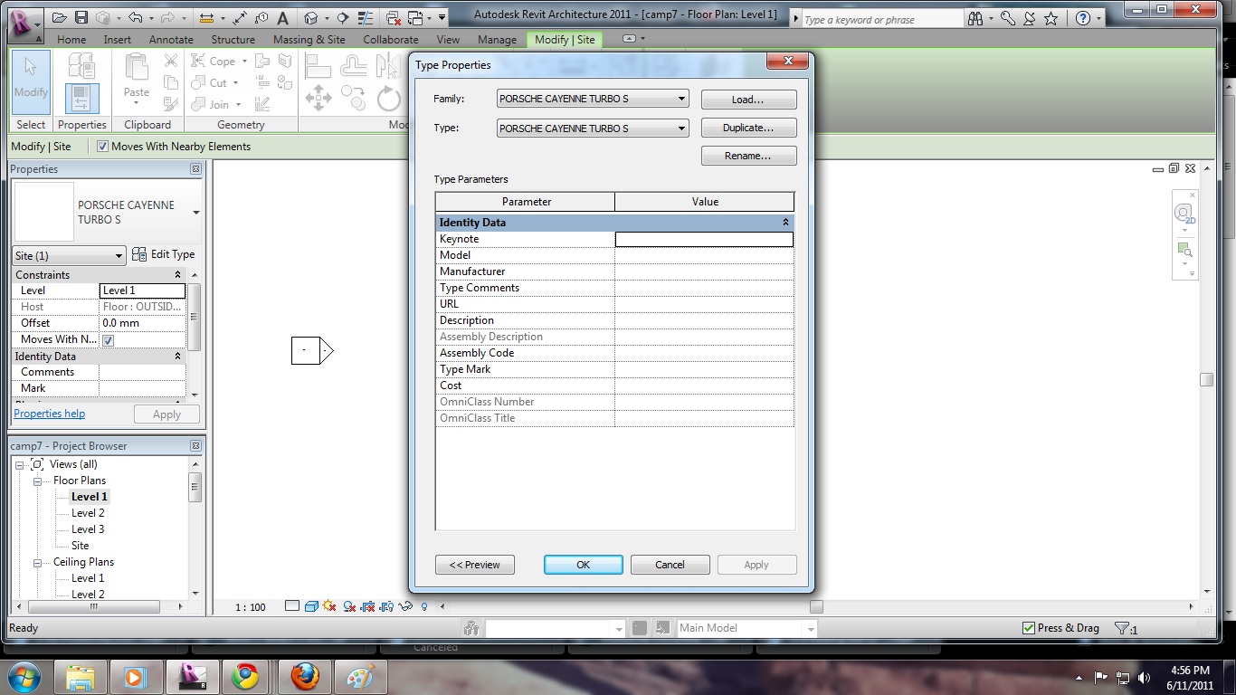

id like to ask for some tips on this one, i actually downloaded a component (car).now when i am checking this on say floor plan the component is there (see attachment) but when i render it nothing is there. i do remember one of the topics while i was browsing this site that they can change the settings>> but when i try to edit it i cant seem to find any tabs or options where i can edit it to show up once the rendering is done. also i have another component and when the rendering is done. the output of the rendered car is grey (that goes with all the component that i downloaded from a website, mostly grey). any tips or opinion will be of great help.

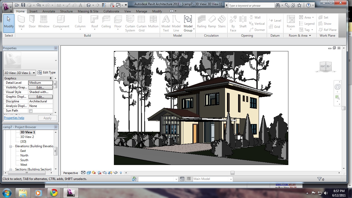

Is that "Car" a 3D model or 2D model only (just lines to see in plan view)? can you post an image in a 3d view (not rendered like that) so we can see?

here it is :-)  >> by the way i downloaded the modem at www.revitcars.com under the free rfa model

The problem is that's not a 3D model but only lines (2D), that's why don't render, you can use that in plan and elevations views but not in 3d views
