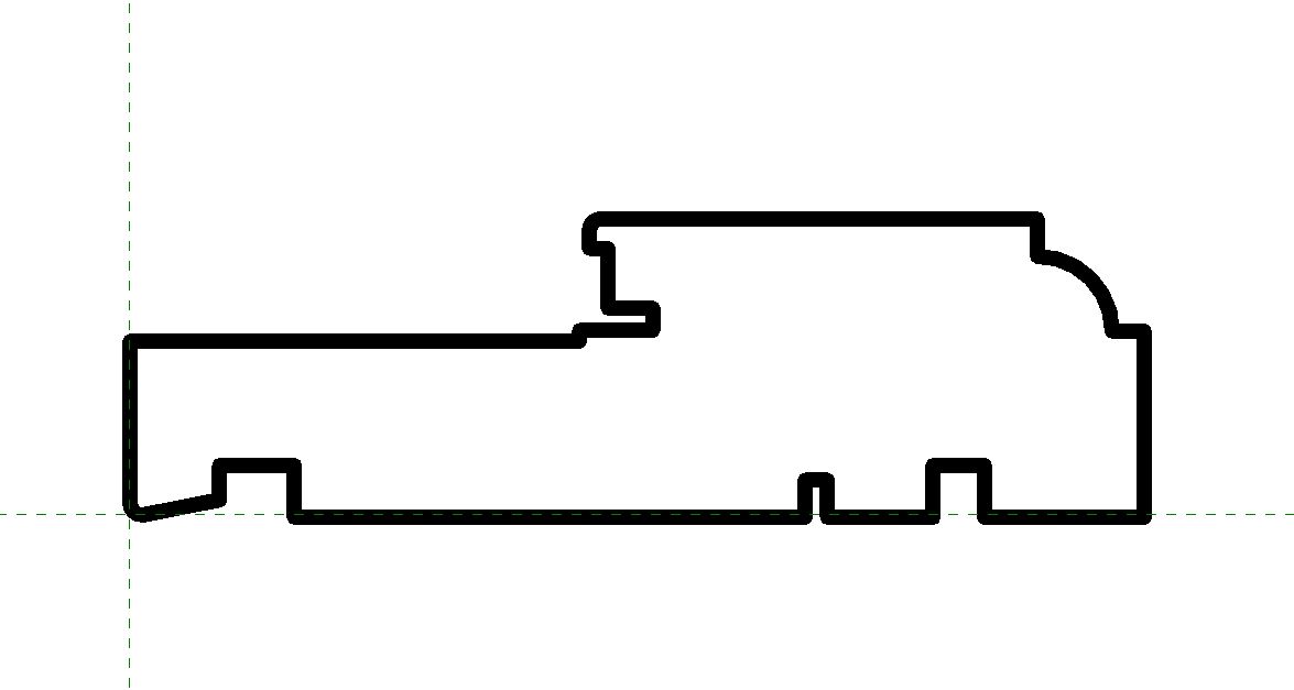

Hi.

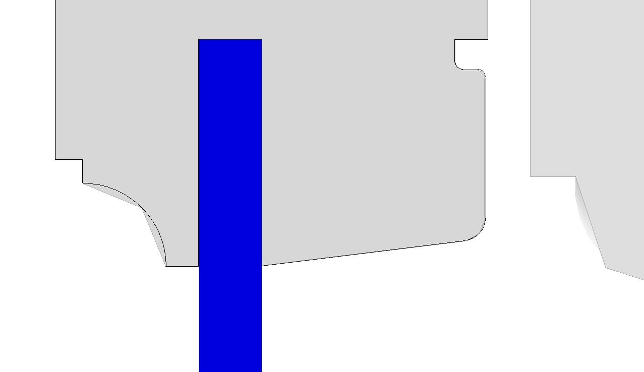

I have experienced problems with arc lines in 2D drawings, especially in window profiles when I have multiple arcs on one or more profiles. When I draw the profile and arcs, everything works just fine, but then at some point the arc lines are replaced by straight lines that tangent the arc.
At first I thought it had to do with some graphic compensation, and that the arcs would print out just as they were drawn, but unfortunately thats not the case.

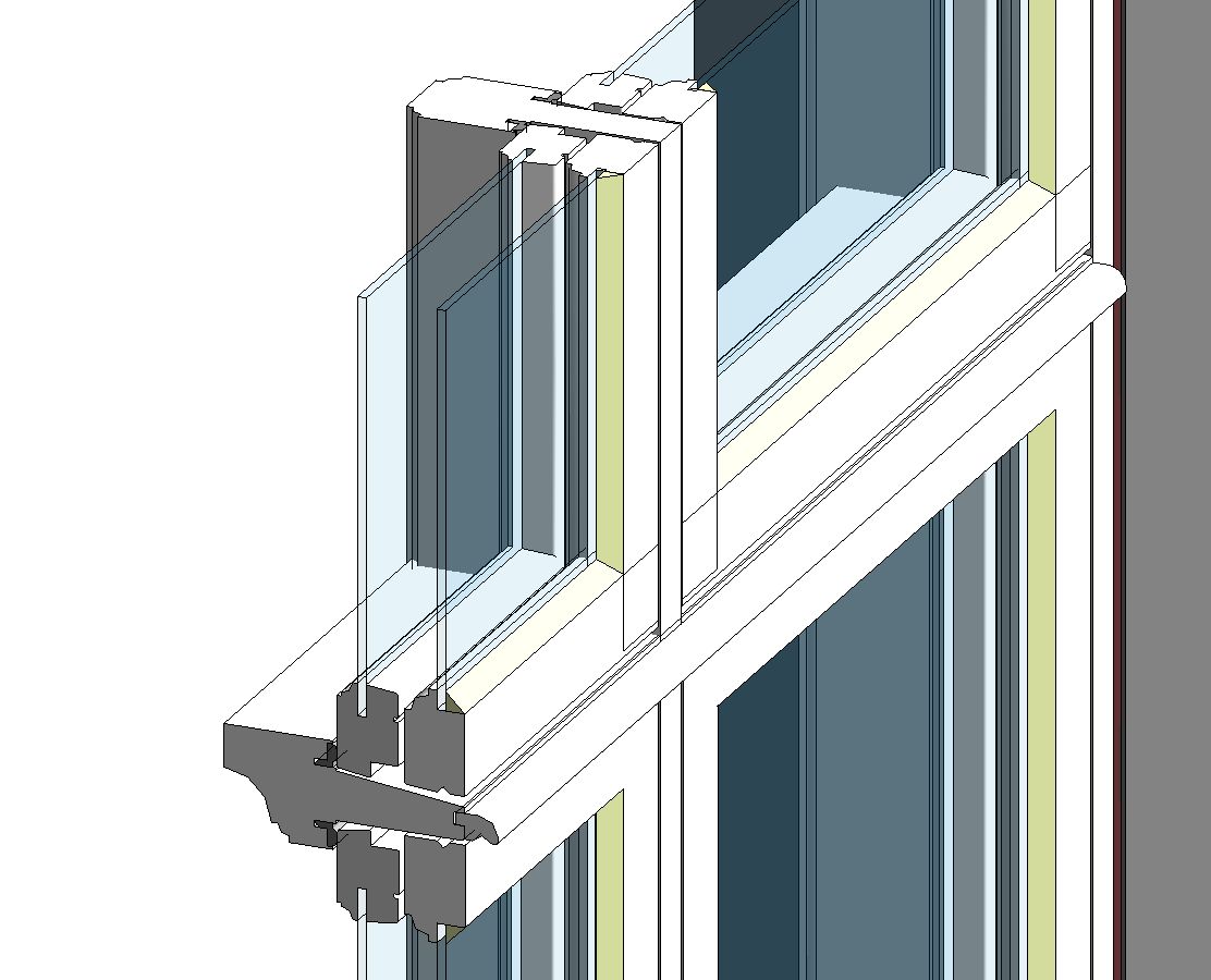

I create profiles as .rfa std., and in the profile family there are no problems with the arcs. But as soon as I load it into my window family the lines convert ? - Note that in 3D mode the lines look just perfect, and there is nothing wrong with the shape except in section/plan/front views.
Ofcourse checked all my view settings and so on, detail levels etc., but can't see what I'm missing.
I hope some of u guys can tell me what I'm doing wrong.
BR/
Jacob Wiinholt

Fri, Jun 10, 2011 at 11:44:07 AM | Arc Lines display as straight lines
This looks like the arc element might be just too small.  Did you import this from CAD by chance?

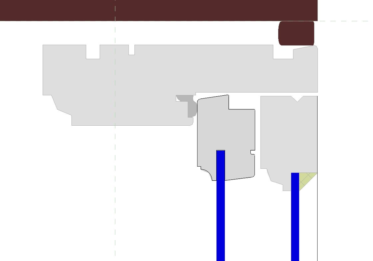

Fri, Jun 10, 2011 at 12:56:30 PM | Arc Lines display as straight lines
Was the view you showed a small sacle view or something like 6"=1'?
You will find that Revit does not like very small units in small scale views.  And besides that... You can't see the problem in a printed view, just on the computer screen when you zoom in closer than the view is set to show at.
Sun, Jun 12, 2011 at 10:07:46 AM | Arc Lines display as straight lines
jawii
Joined: Sat, Oct 25, 2008
22 Posts
It's not the scale or the detail level. I've tried a bunch of different settings but the arcs still don't change.  (shown views are 1:5)
And as you can see on the attached .pdf, the straight lines does print instead of the actual arcs! -otherwise I wouldn't have posted the question.
