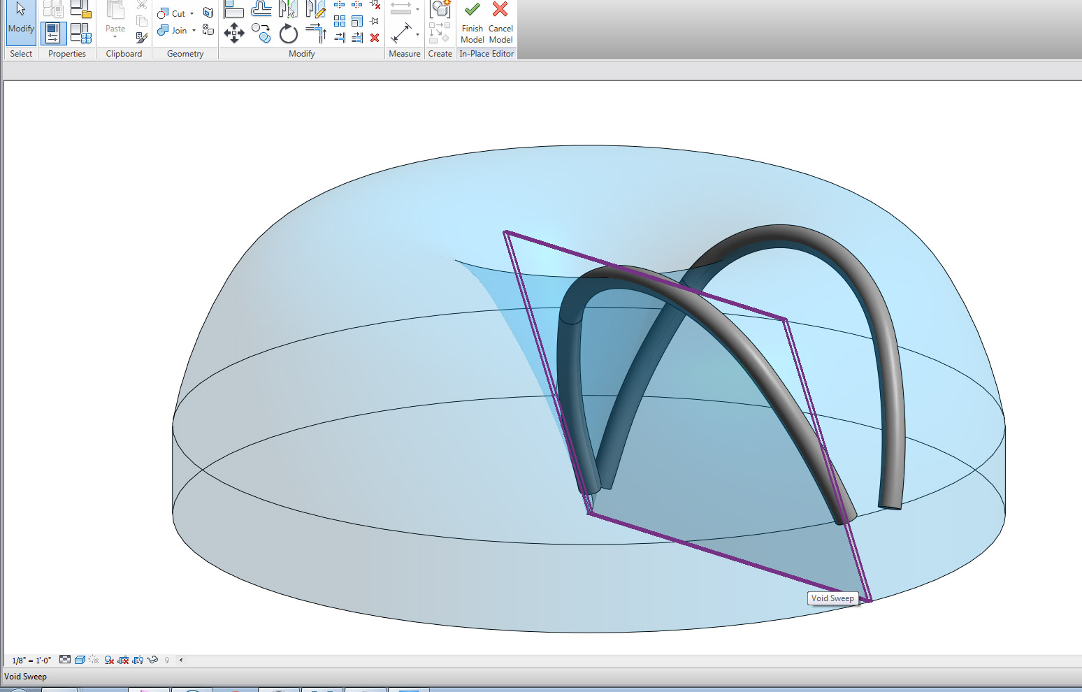

something like this?  I was a little unclear.  But there's no need to take it to Sketchup, revit can do more complex geometry than that program.

I doubt you could analyze this.  But I have no experience with structure.  This is a modeled in place sweep, and I use revit arch. same principles, maybe the program you export to will understand.
The steps I went through to create this was:  Make a sweep or revolve with the arch you want, from the retaining wall/stage to the ground.
create a thin void sweep from the outside to the center, at the angle you want, in *elevation*, and any addition curve you might want in plan.  make it very tall in profile so it cleanly slices through all your donut.
When finsihed and cut, it'll provide a clean cut line that you can use to "Pick Path" for your next sweep, being the 30" tube.
you can then copy and array this tube sweep as you see fit.

it would be better to know what you want, first, or else you'll have to update your first beam redo the array, I think.  unless they're grouped... but groups are finicky, especially with sweeps...  You could also make one beam as a family, and then updating it would be a relative breeze.
