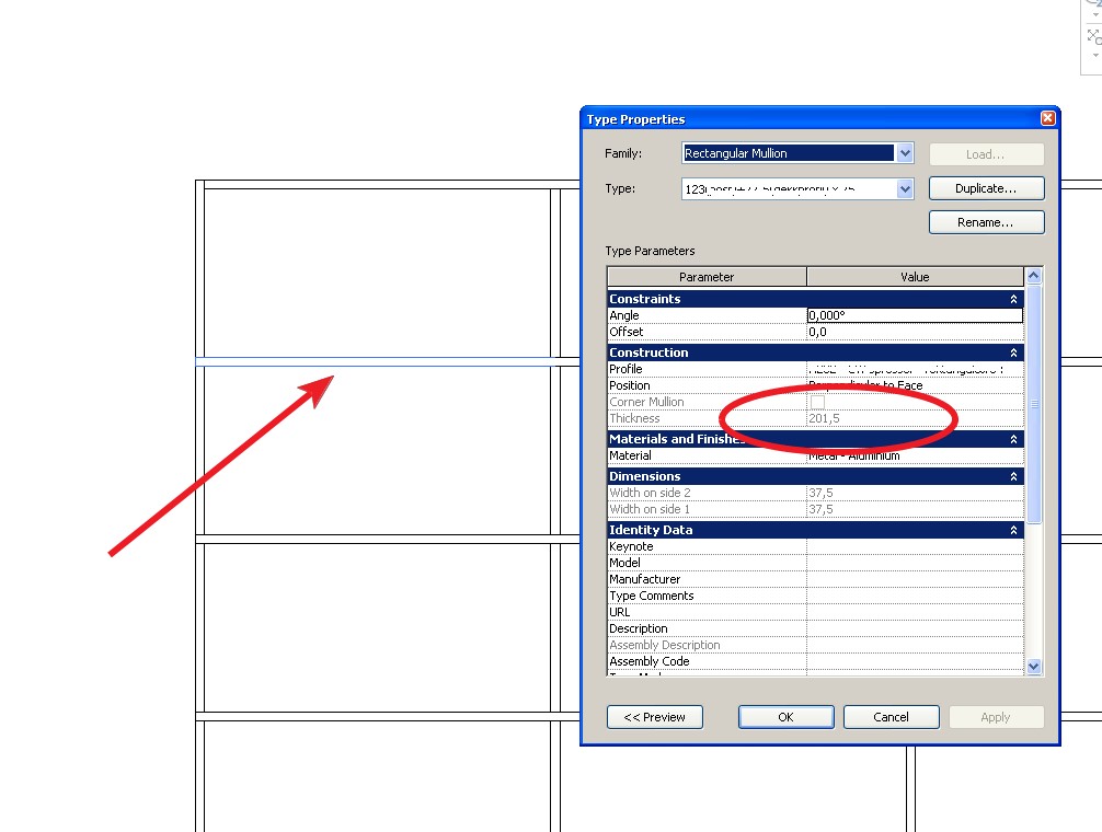

Hi
How can I change the thickness of a mullion?
Please see the attached jpg.
The thick ness of my mullion is 201,5 as shown in the type properties, however it's gray out.....
How can I change?
Thank you very much.
Tue, Jun 7, 2011 at 9:21:08 AM | How to change the thickness of a mullion
This is a type variable.  You have to edit the type or create a new one.

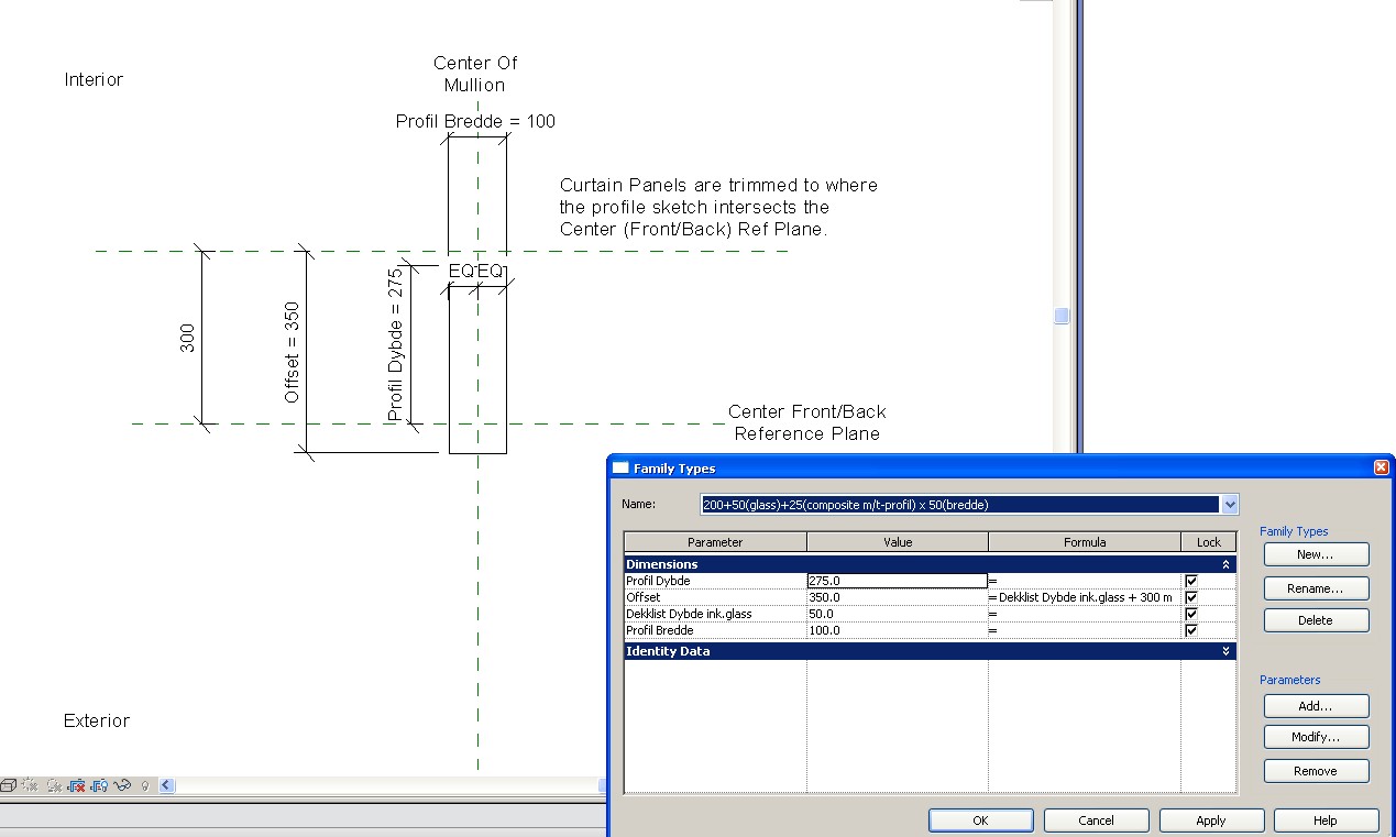

Wed, Jun 8, 2011 at 2:24:32 AM | How to change the thickness of a mullion
shenlunglinnk
Joined: Tue, Mar 23, 2010
50 Posts
3 Stars: 2 Votes
Hi
Thank you very much for your reply.
I try to find the original family, but the thickness number 201,5 is not there .....:-(
How can I edit the type?
Best regards

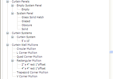

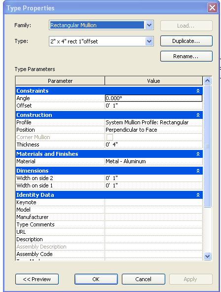

Wed, Jun 8, 2011 at 7:57:12 AM | How to change the thickness of a mullion
You do not do this from the family editor (although you can).   Find the family and expand the types as shown attached.  Right click on the type you want to change and pick type properties to see the settings as shown in the second image attached.
Rules for the type seetings for mullions can be found in your HELP: Rectangular Mullion Type Properties
