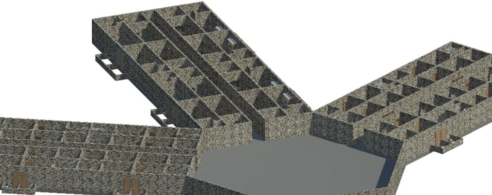

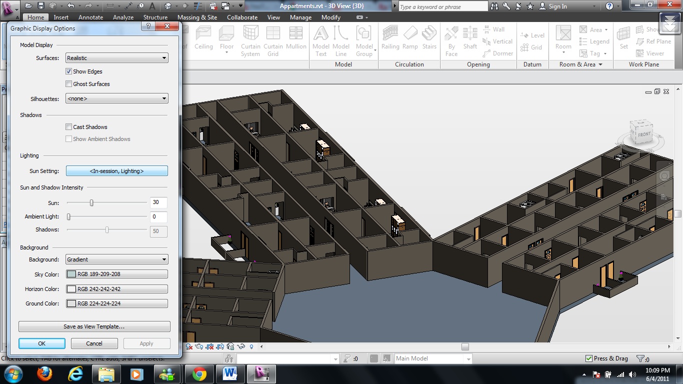

when i chenge the model display style to Realistic, its acting as Shaded style.. Before It used to work properly, when i closed n opened the file, its coming like this... Other display styles are working roperly except for realistic. I am having the same issue with some other files as well but not all of them.. Please help.. I have attached 2 images, one is before render and other is after render just to show whats happening to the material..

Looks like you have made everything as existing. Existing does not take on color.

I'm sorry I didn't understand you. What do you mean existing? I didnt change any options as far as I can remember, after closing and then opening it again, it turned out to be like this... Most of my other files became like this too except for one...

select an object look in properties box for phasing. if it says existing then that is likely your problem. look in help file about phasing. I think you will find a simple way in there to move all the objects to a new construction phase without having to select them all. Good luck

I tried changing Phasing but seems like thats not the problem, nothing happend related to the realistic material texture.

Rendered output is unrelated to view style.
Realistic is supposed to look more like a rendering so you don't have to render to get a "realistic" view.
I don't understand realistic view because mine never look real. Must be missing something.
To get the rendering looking good you need the render materials, lighting and settings sorted out.

@mcantwell - I attached a rendered view just to how how the facade treatment actually should be when i am in realistic view. So even are you having same problem that im having?

In options (under the big R), under Graphics tab, the ''use hardware acceleration'' must be checked. However, you might have some problem with element sections.

Ditto what jfcarch posted.
However, I noticed really bizarre behavior of the Revit when platform when I checked the box like not being able to select anything.  Oddly I can select things now, but it takes a few clicks to get just a roof highlighted.  With Acceleration unchecked, it runs smoothly as it should.
