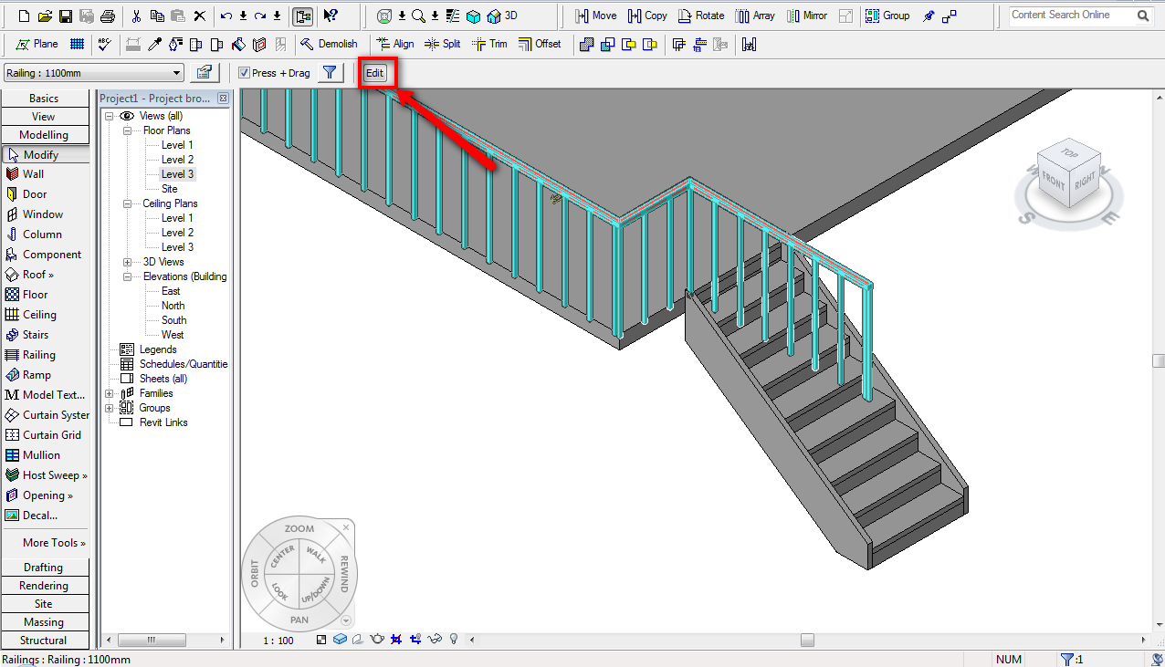

I have a railing that I can't attach to the stairs. Do anybody know how to attach this railing?
Tue, Mar 24, 2009 at 8:03:26 PM | railing
#9
erland73
erland73 Avatar
Joined: Fri, Sep 7, 2007
738 Posts
4.5 Stars: 85 Votes
Hi albertstwrt, 1-Pick the railing and then pick on "edit" button (see images)
                    2- pick "Set Host" button and pick the stairs
                    3- finish sketch  and that's all.....
