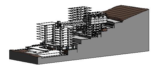

I can't figure out why a level view that cuts through the toposurface shows blank spots where there are pads in the levels above.
Using Revit Architecture 2011.

Maybe I'm not explaining myself correctly... I do cut the topography with pads, but I have many levels, and I don't want to see the
blank space that the pads leave in the plan views of levels that are below these pads . I just want to see filled earth, because there
is no reason to see them in the plan views that are under tham...
Also, for some reason, one of these above pads does not leave the blank spot, eventhough it is defined correctly and cuts the topo.
