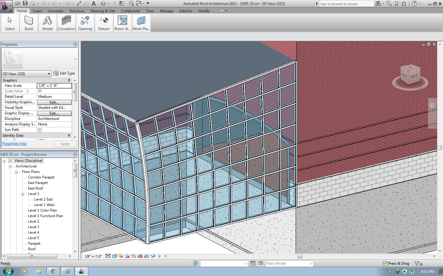

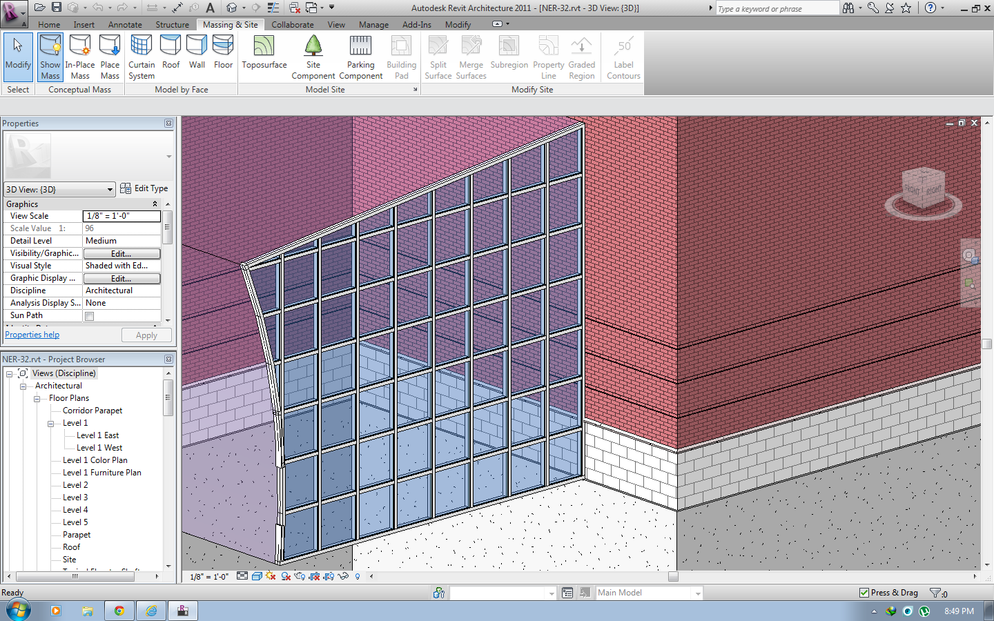

how do you apply a curtain system on a massing such that the grid/mullions follow/conform to the shape of an irregular 2d face.for example, one side/face of that massing is not a square (three sides are straight while one is curved), how do i apply the curtain system such that it wont look like a "square grid" superimposed in a non square face.
i have attached a screenshot of the case
the first pic is what i'm getting, the second pic is what i want to achieve.btw, the design is from the book by eric wing that i'm using as a training book.

Watch the video: http://screencast.com/t/GypLNEhKOs

Thanks Typhoon! thats great. it certainly solved my problem.
