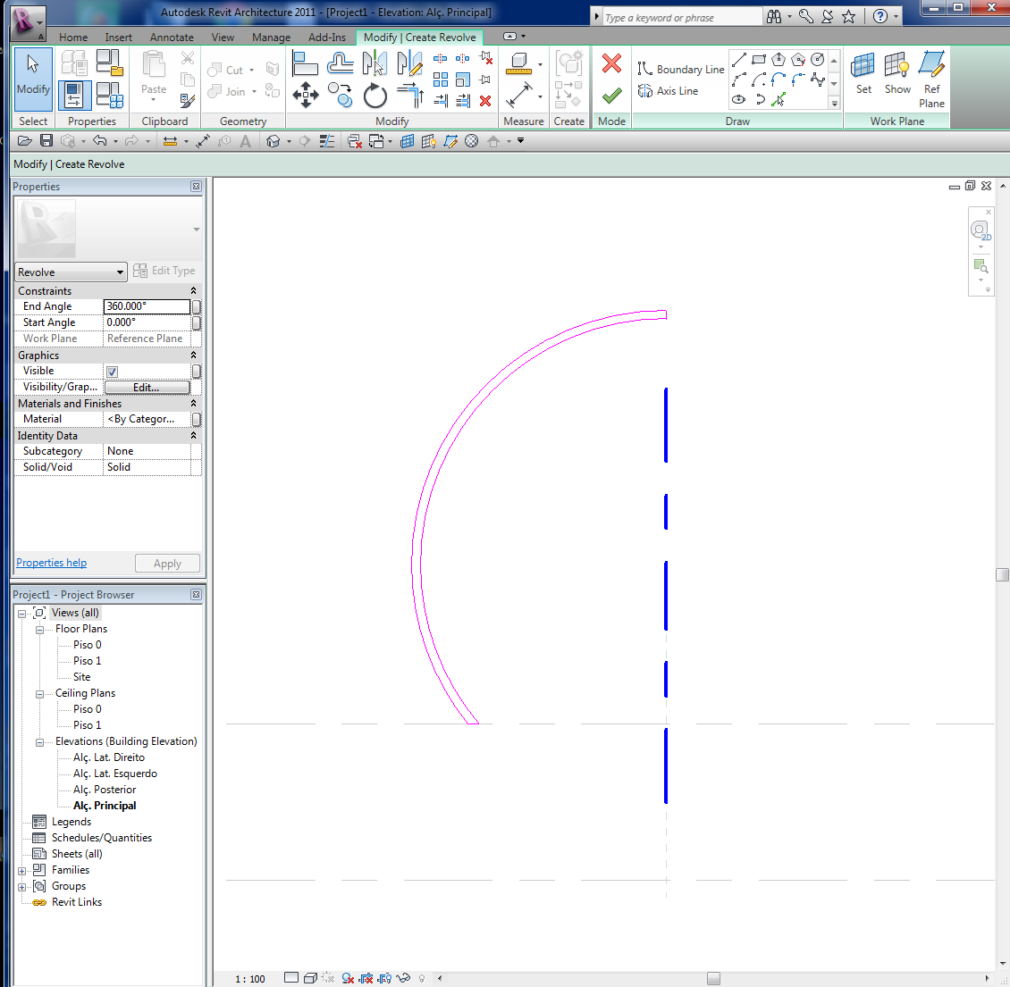

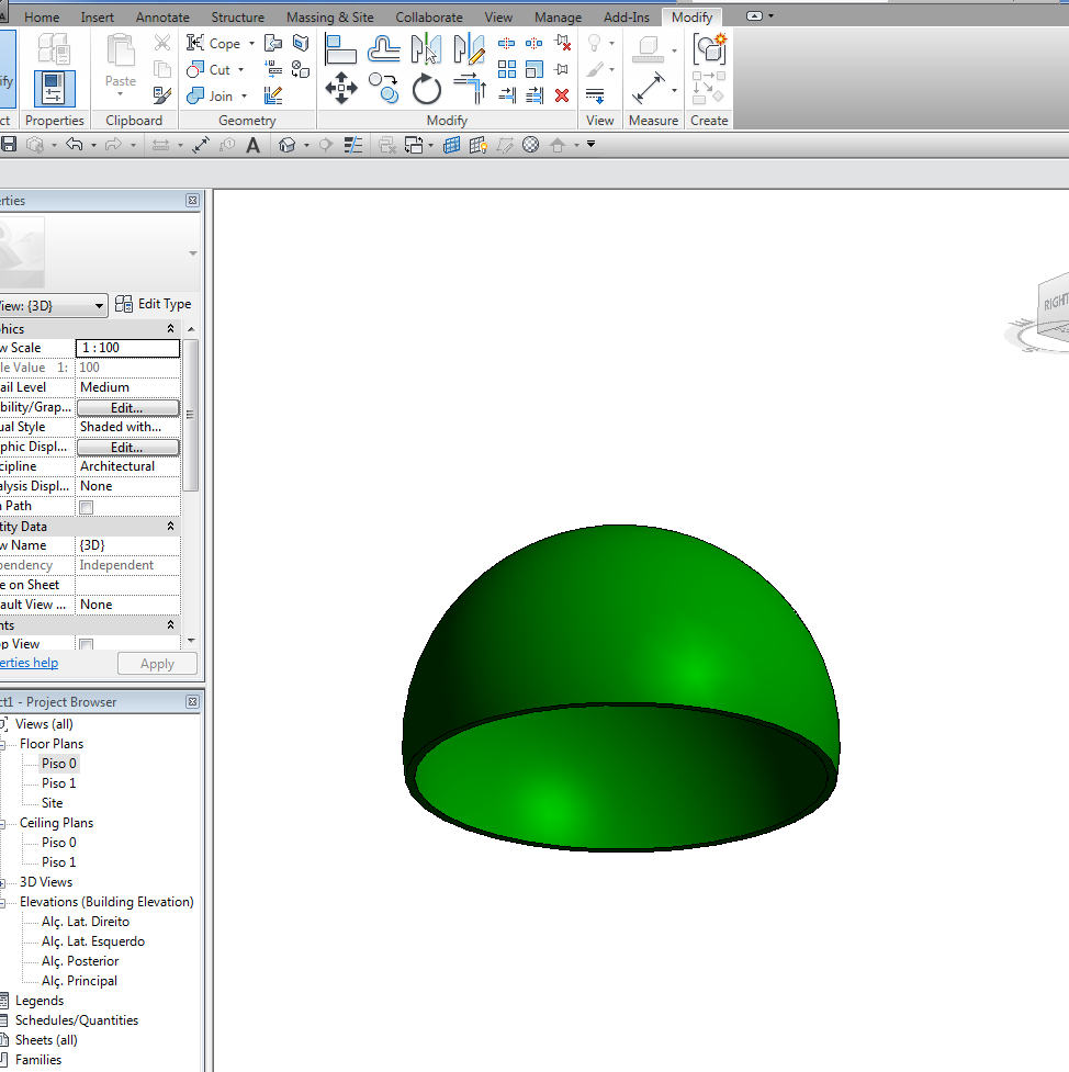

You can create directly in your project an "In-Place" family (Home > Component > Model In-place) in a "Roof" category with the material/texture you want.
Put some images so we can see what are you talking about.

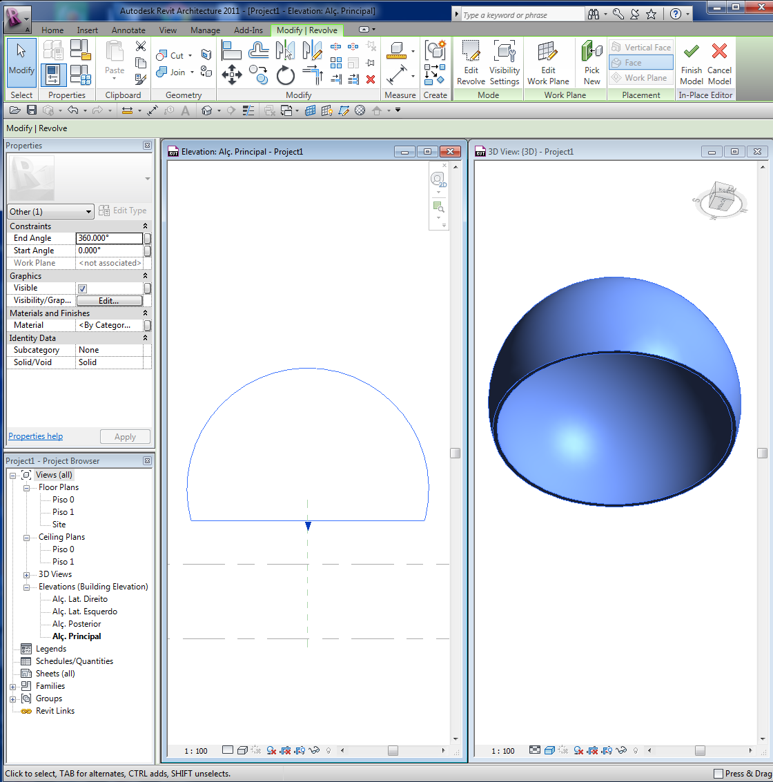

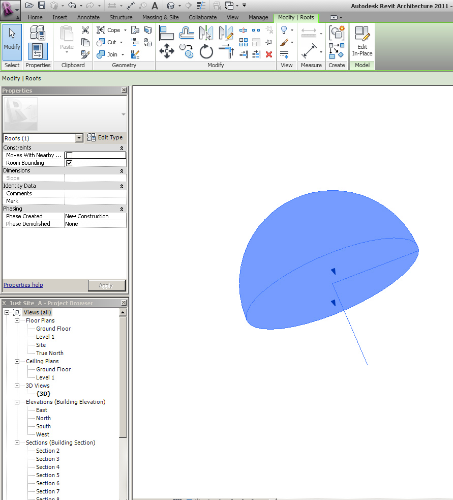

The image you attatched is exactly what I need, however I am unsure how to create the hollow sphere following your instructions above. I have been able to create a half sphere using the model In-place, Roof catergory, however the sphere is still solid.
If possible, could you tell me the quickest method to create the sphere, as the way I am currently doing it seems quite difficult, and isnt working. My current process is as follows:
1) Home > Model in - place > Roof Category2) Model Lines > Lines > Draw half semi-circle (within Level 1 Floor Plan) 3) Home > Revolve > Specify Boudary and Axis Lines4) Click the tick, and then finish model

Just sketch that with the thickness you want like you can see in my first image...
Hope this help
