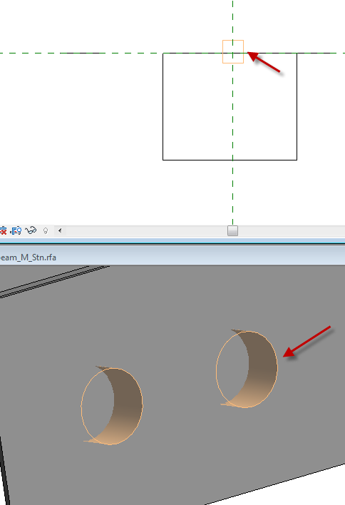

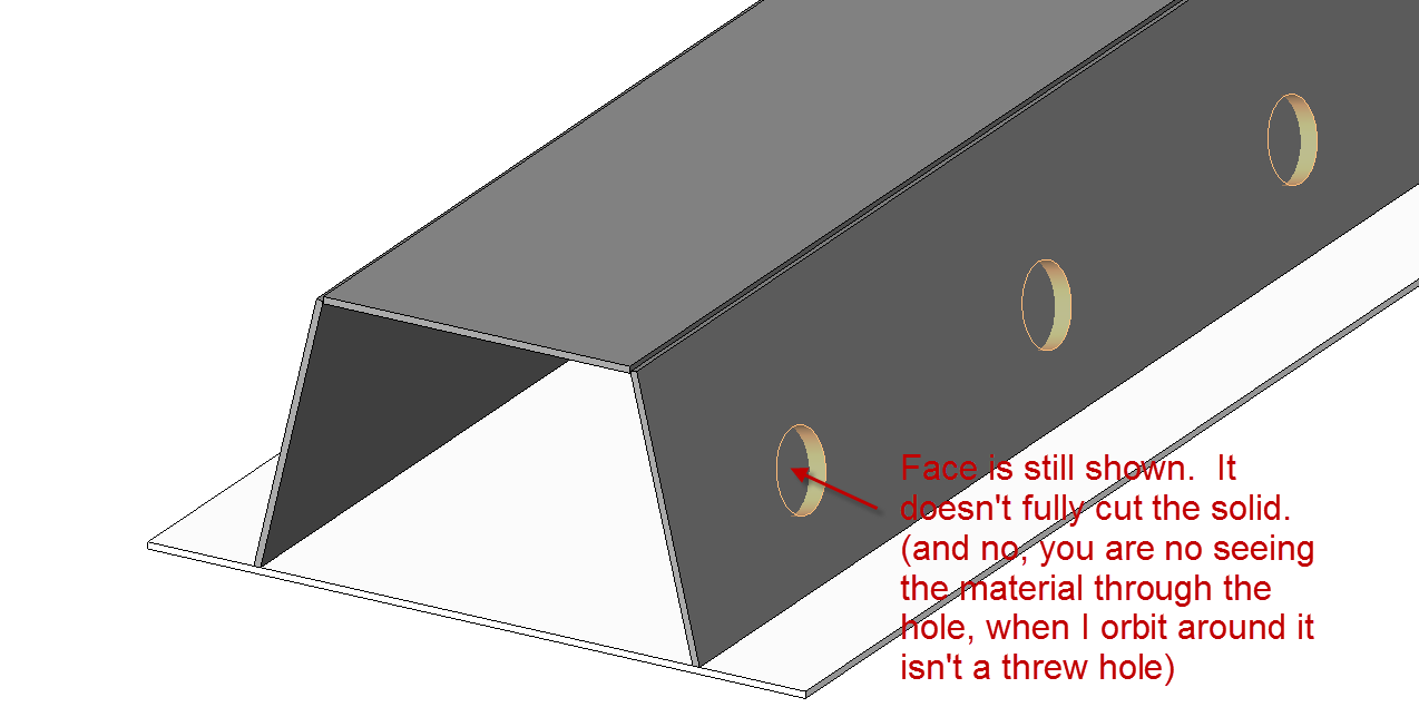

Yea I cant get it to cut anything.
I have attached my Revit 2011 family.
The one side of the beam I have placed two nested void familys (I will eventually array these using 300 c/c spacing, 150 from each end) but for now, I just want to be able to cut the beam.
One side of the beam I have tried using non-nested voids with arrays.  (Not the best option and doesn't work fully when I flext the length)

I won't be back in the office till Tuesday so I can't test tonight (no Revit on this laptop), but there's a couple things I can think of to check. In the family you are nesting (the 'hole') family, did you make the void extrusion cut the default face (the big block in the family)? In the beam family is the nested family somehow backwards so the void is extending out away from the extrusion instead of into the extrusion?
Sorry, that's all I can think of right now, unless I come up with anything else it will have to wait.
Fri, May 27, 2011 at 10:29:42 PM | Use Nested Void Family to Cut Host?
mfleming
Joined: Wed, Oct 20, 2010
8 Posts
Yea It is cutting the face.  I also tried cutting the entrie block (it doesn't actually cut anything in the void family though) ie. the big block.
I have also tried switching the void extrusion in case in was upside down.  Still no go.
In my main model it stays "orange" all the time representing a void extrusion.  But nothing gets cut.
See attached

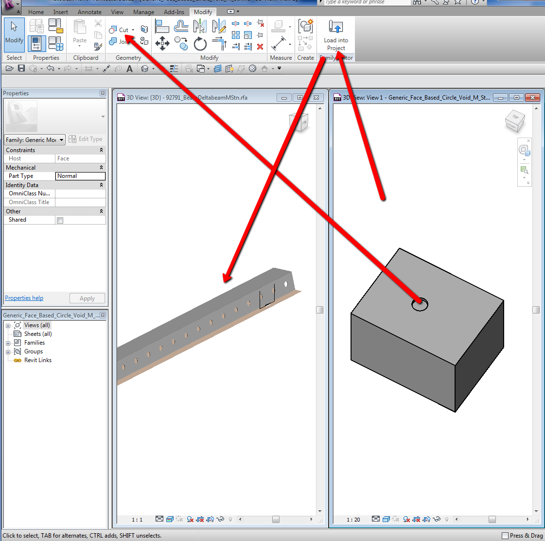

Select that void and "Edit Family", now use the "Cut geometry" tool, select the void and select the box, load into project, overwrite and its done.
Sat, May 28, 2011 at 10:39:48 AM | Use Nested Void Family to Cut Host?
#9
mfleming
8 Posts
I didn't think about cutting inside the void family... NICE!
This worked perfectly thank you!
