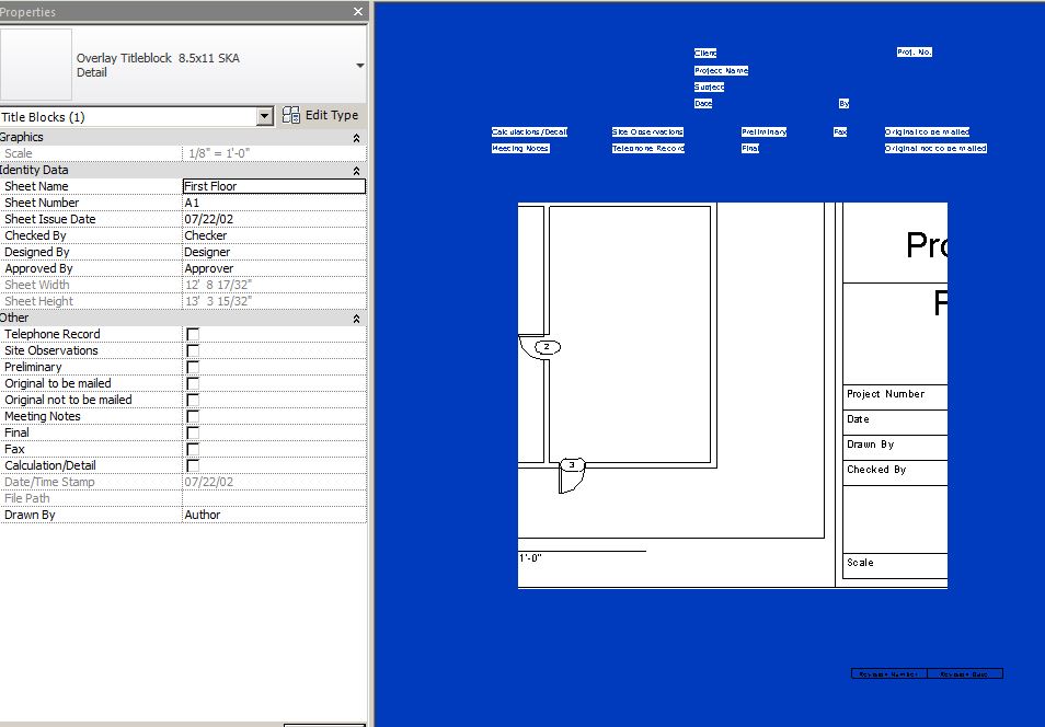

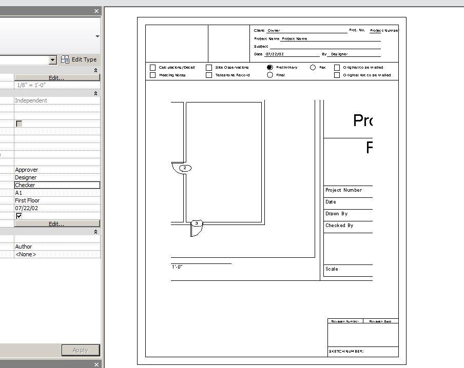

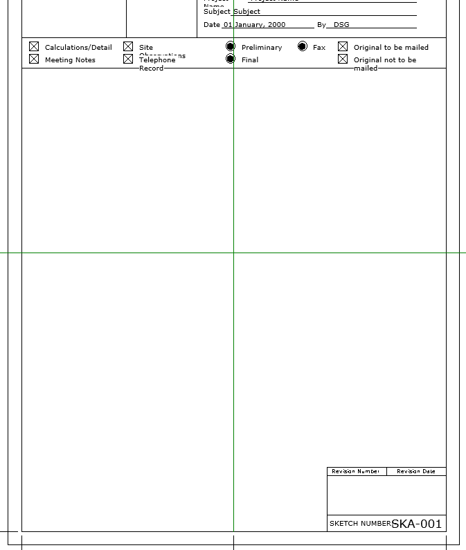

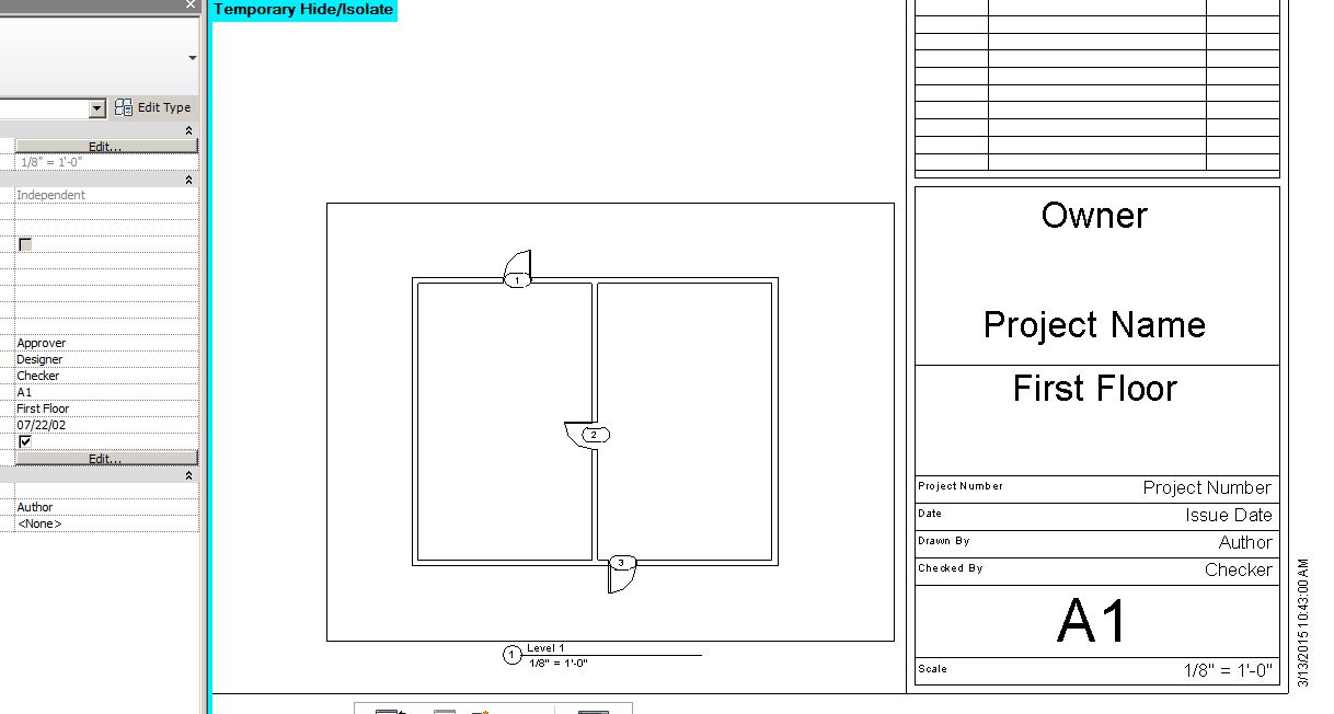

Look at the images below.
  1. The original 30x42 sheet with a view
  2. The overlay has been placed and you can see the adjustable window as well as the properties.  This sheet has check boxes you can use to descibe what the sheet is for.
  3. This view shows what the sheet will look like when printed... see how it masks the original sheet.
  4. The overlay family.
Process is to make your sheet revisions then place this over it and print.  Now delete this overlay because your PDF is the record you want.  The project sheet will correctly reflect the revision.

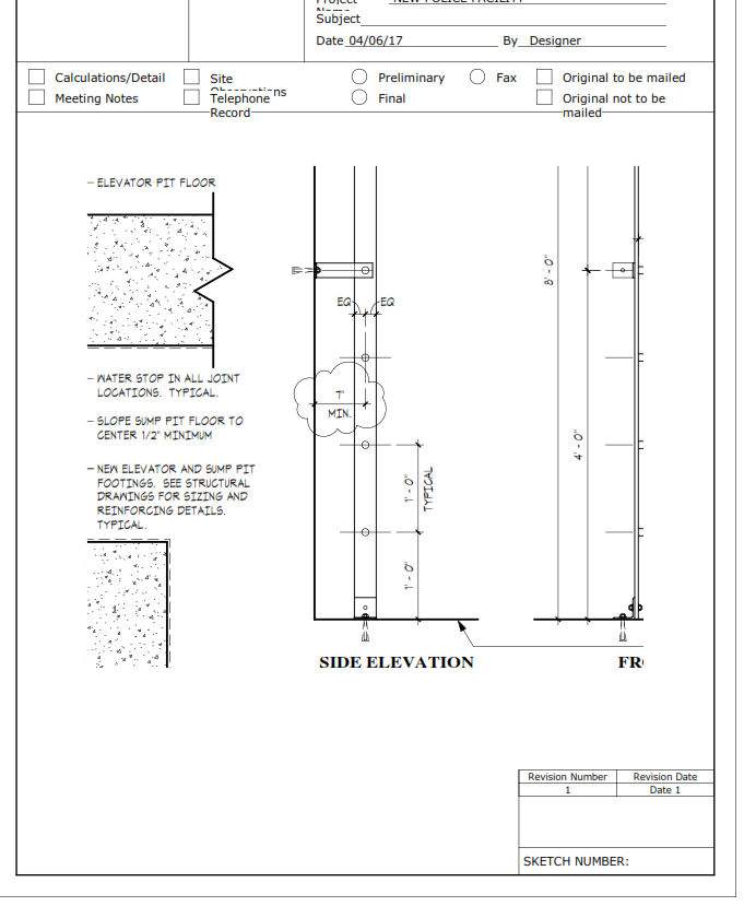

Capture.PNG is of the sketch within the project's established sheet.  Notice no sketch number or subject.  I have absolutely no idea where these parameters are populated.
Capture2.PNG is of the sketch overlay family edit mode.  Clearly there are labels for the sketch number and subject.  Again, once inserted into the actual project these dissapear and I have no idea how they are populated.
