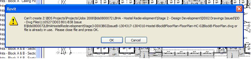

I have tried exporting a .dwg file of a project I am working on via:
File > Export > CAD Formats - And changed the file type / file name etc / options / selected sheets.
However when I click save, after a brief moment Revit displays a dialogue box containing an error message.
I have tried creating the .dwg file on other computers linked to the server, and the same message still occurs.
I have attached the error message via a .jpg file.
I am wondering if anyone could explain why this is occuring, and how to resolve it.

I have also tried exporting one sheet at a time, but the error message still arises upon saving it.
Any advice or guidance on this issue would be appreciated.

Fri, May 27, 2011 at 7:45:21 AM | Exporting a .dwg File
No attachment. We would need to see this error message.  The export process is normally very easy.

Sorry about that. I thought I had attached the image.

It's okay. I just worked out that it was because the file name was too long when saving.
All I had to do was specify a shorter file name to edit after the save, which in the end let me save the files / views.
