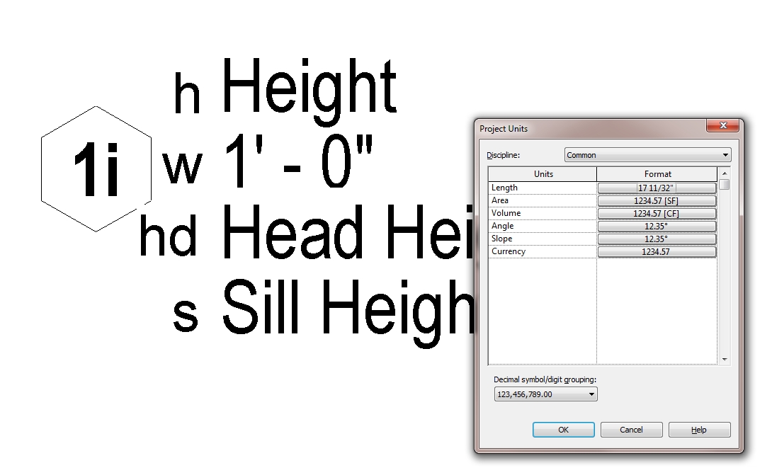

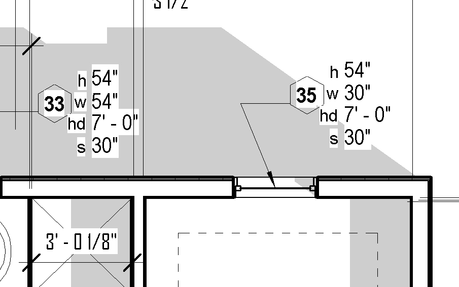

I've created a window tag, attached.  the 3rd tag "head height" displays in feet and inches (see jpg attached), all the others in inches.  What setting controls this?

Mon, May 16, 2011 at 7:25:38 AM | tag display paramenter
Your tag is probably set to use project units.  Open the family and adjust this parameter to use inches instead of project units.
Mon, May 16, 2011 at 9:59:44 AM | tag display paramenter

in the family, project units are set to decimal inches.  what commands are you suggesting that are different than that? see attached project units in the tag's .rfa

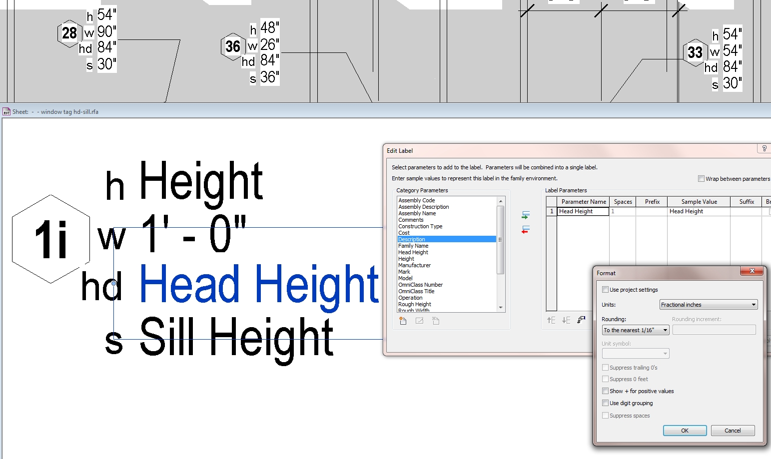

Mon, May 16, 2011 at 10:15:03 AM | tag display paramenter

Edit the label. In the list of parameters in the label, select the one you want to change. Click the 'Edit parameter's unit format' button. Change it to how you want it to read.
Mon, May 16, 2011 at 10:16:48 AM | tag display paramenter
Not the project units of the family but the units of the parameter in the tag family.
Read this topic in your HELP:> Edit Label Unit Formats
Mon, May 16, 2011 at 2:50:11 PM | tag display paramenter

thats it, thanks... it's the tiny little # sign in the dialog box... see attached (right next to the words "rounding to the nearest 1/16").  couldn't find that before.
