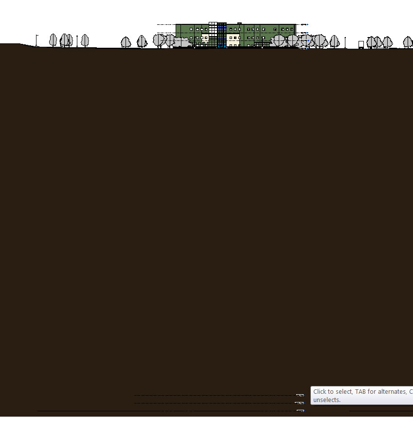

Thank you cbeiser.  I appreciate your thorough answer.  Maybe this is where there's a problem, in that the original models levels aren't at 0'-0", but are at the true elevation of 625'-0", so instead of using a shared coordinate, the original model was literally built at a height of 625'.   WWhub was helpful in that he pointed me in the right direction, but after reading about the shared coordinates and applying them, my model 's elevations were still at 0'-0" but reading 625'-0" (as i imagine that they should be), which leads me to believe that the original model, was build incorrectly.  i have attached an image to help visualize what i am talking about.  As you can see, my levels start at 0'-0", but read 625'-0".  the existing model is attached and you can see that the existing levels are at 625'-0".  I'm assuming tht this is incorrect and that the existing model should have be built on the 0'-0" datum and referenced the coordinates of 625'-0" , correct?

Stupid architect syndrome i guess, but...forgot to attach the image from my previous post.

I don't think it will matter where it was built.  It should work like this:  Project coordinates are 0'-0", shared are 625'-0".
Go to elevation view, select a level, edit type, change elevation base to shared or project.  Whichever you need to change is when you Relocate project which will prompt you to move it.  You should then be able to switch back and forth (depending on which information you need to convey) without having to affect the physical location.  HTH
