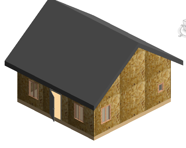

Hi, well, I just built a square 24 x 24 walls. Then I put my first roof on. It's gray. even though I do have it set on realistic.

Thanks, I read those. Then I clicked on my roof, materials, Roofing-Metal Standing Seam, Render Appearance tab, replace, Roofing>>
Then I see the list of shigles, spanish tiles etc. But I don't see the tin roof I want. Is there a way to make that pattern and put it there?
