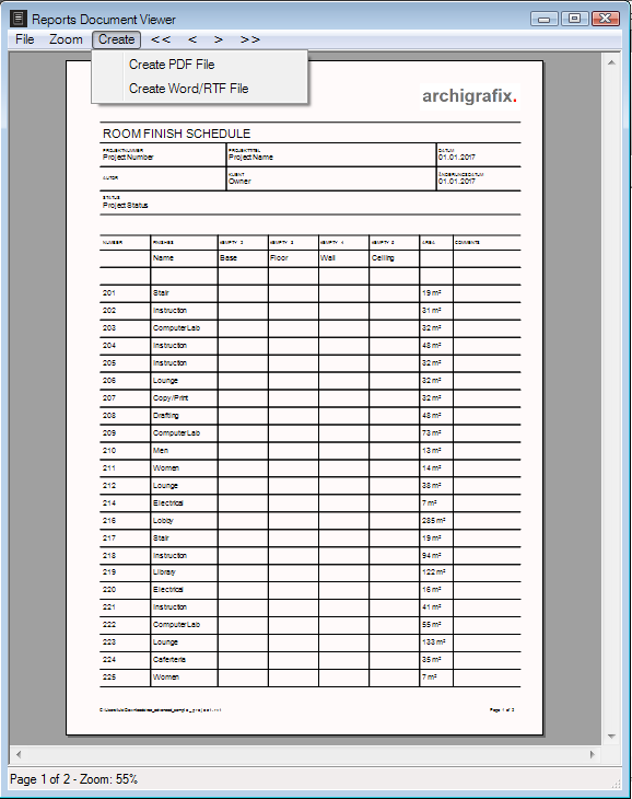

This is an old post but relevant for many. For those interested in printing long Revit schedules, or exporting a professional looking schedule in PDF or WORD directly from Revit, please have a look on the solution we developed: Archigrafix Reports. The tool alows to split the schedule in multiple pages. There is a free trial on the website.
http://www.archigrafix.com/reports-2017-perpetual.html
Trial:
http://www.archigrafix.com/downloads
Any comments are welcome!
