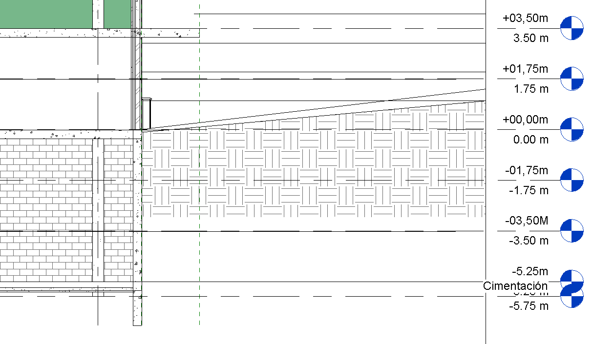

Hi,
I have a topo surface and on my building sections it shows the cut fill only down to certain level. I have no clue how to do it to show the earth fill down to my foundation level.(see the image attached)
Can anyone tell me how to control this?
I am using RAC 2011
Thanks

I think what you're looking for is on the Site tab --> Site Settings, set your depth in the section graphics area
