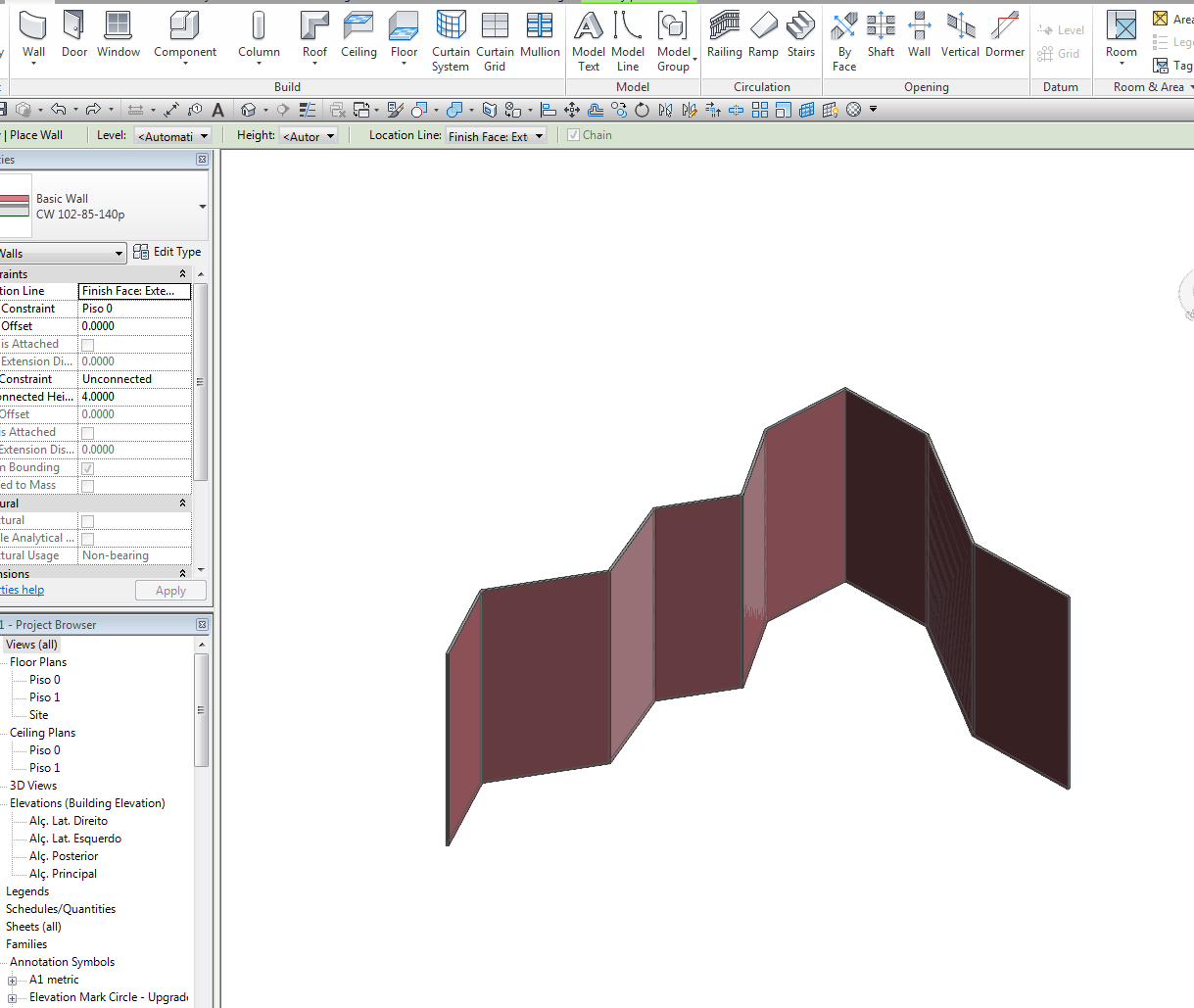

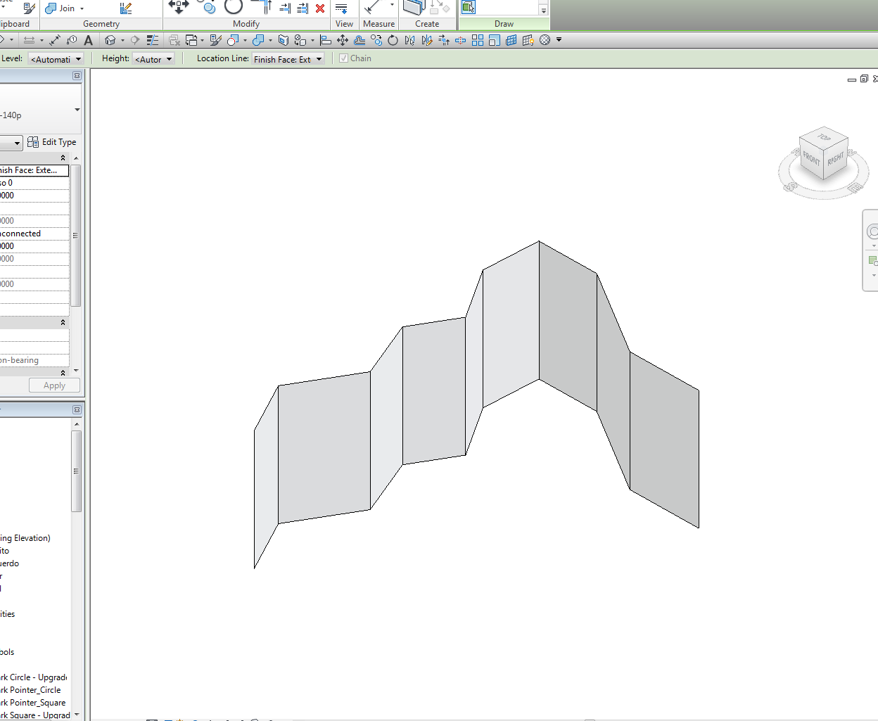

Hi,
I have a lot of faces I like to select and change to walls. Is there and easy way? It seems like it's not possible to select multiple faces when entering "create walls by faces"
Thx
This user is offline |
Joined: Tue, May 22, 2007
5921 Posts
Use the "TAB" key to select a chain of faces...
I Hope and I Wish to LEARN more, and more, and more.... REVIT |
Joined: Fri, May 6, 2011
9 Posts No Rating |
Waw, thx !!
