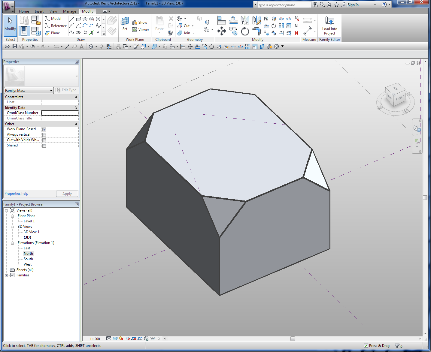

I am doing a massing model and we are slicing the corner.  I am having a hard time doing the slice at a 45 degree angle.  Does anyone have an easy way of doing this?

Something like this?
VOID BLEND

Another solution: http://screencast.com/t/nLzF48zlOpJt
