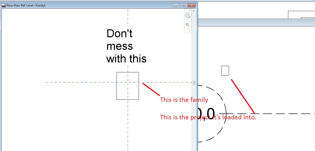

You could add text in the ref. plan.  That'd get the message across.  by default it won't show up in plan in your project.  But I agree that you should teach some good practices to your coworkers... to NOT go in and modify a family to suit one's situation in a single project.
Otherwise you'll end up with a lot of weird broken families.  Either suggest they learn to make parametric families, duplicated and modify families of their own, or build more in-place families.
meant to attach image
