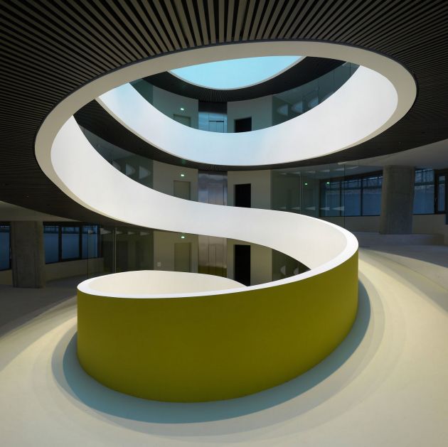

i hav some ramps in which i need to provide a wall as a railing till a ht n den a nrml railing...is dere ny way i can make a railing which is such...or is dere ny such file in here which is such
coz editing the profile of the wall everytime to align it with the ramp is difficult..and dere are many such place..!!
i hav attaches some image.. just for reference

If I understand correctly, you are looking to make a ramp of a certain shape, which has a wall which is a certain height, etc.  I only have two methods, 1, the way you are doing the ramp, placing a wall, attaching its base to the ramp, then modifying its profile to match the ramp.  The second way, do the same thing for the wall, attaching base to ramp, then copy ramp and move it up until the bottom of the ramp is at the point you want the top of the wall to be, then attach the top of the wall to the bottom of the copied ramp.  Create a workset called hidden, or something of that intent, and make it not visible by default.  P.S.- I might be wrong on the ramp moving up, it might have to be floor, I'm not 100% sure the wall will attach to the ramp.  Anyway, I always thought the Ramp tool was garbage, I just used sloped floors anyway...

Why not try to make a railing baluster as a wall then it will follow. the ramp (or stair)?

I am actually intersted in how exactly did you model the ramp you showed in the rendering of your origial post.
