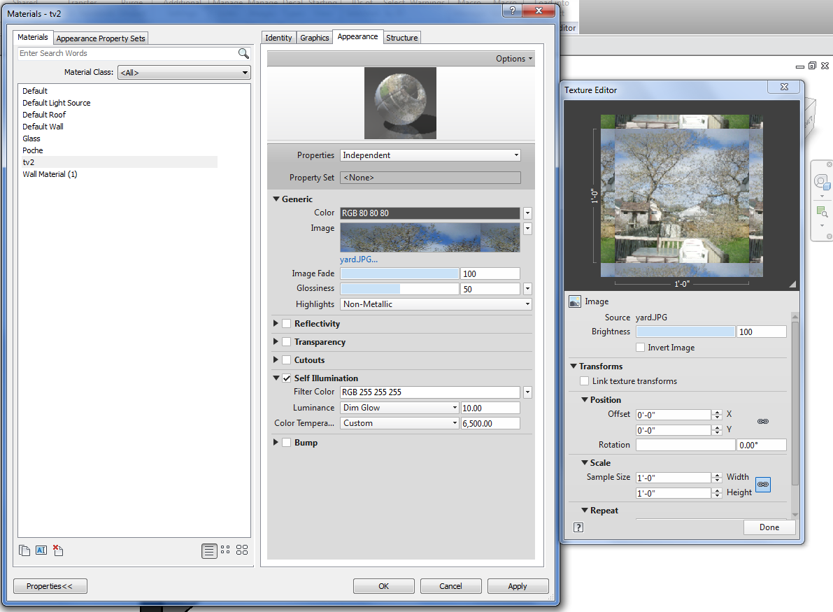

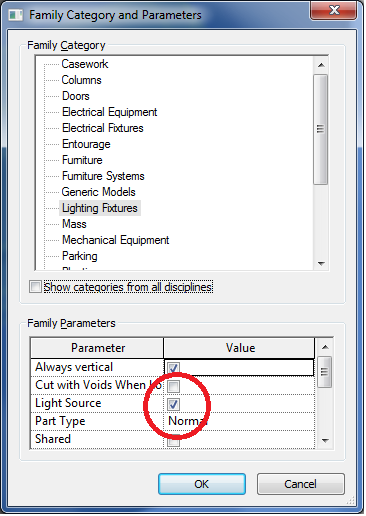

I've tried this before with a Decal without any success. I ended up creating a new material and used my Picture file as the material pattern. "Edit Image" and scale it to be the size of your TV screen. Then check on the self-illumination setting and ticker with those values. It will appear bright but it won't illuminate any of the surroundings unless you make it a light source under it's Family Categories. I hope this helps.
