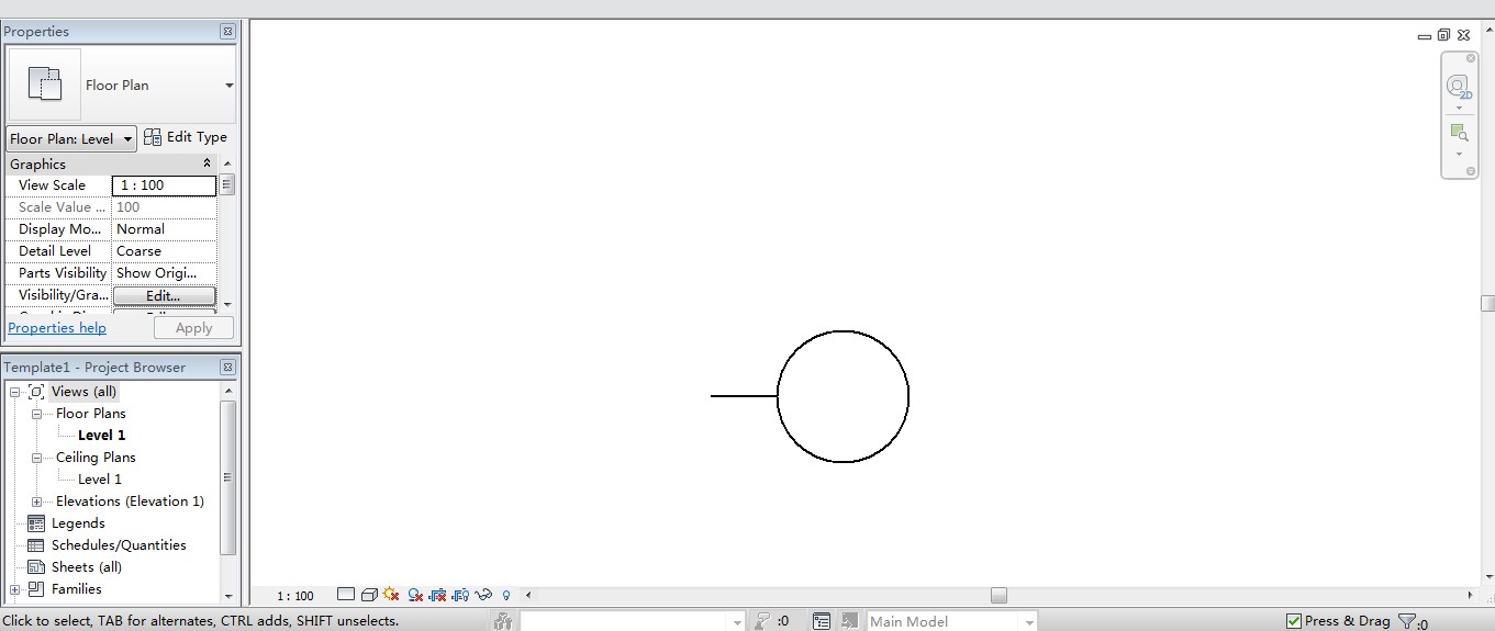

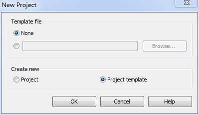

I means no matter you create a project or a template ,
you could choose a template or none template from the new project dialogue option as the pic 1 which I have uploaded.
Then I click the button to create a new template project...
You can see the pic 2 that the RAC  have already create a default level which called level 1..
But there is no any elevation view in the project browser....

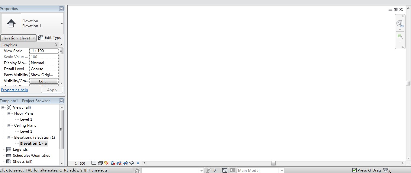

So I create the elevation view by myself as the pic 3 ...
After I create the elevation 1 -a as the pic 4..
there seems nothing in the elevation view....
So where is the default level....

I find the default level finally...
The fact is that level is also a 3d line which is set near the system base point which also been hide in the project...
You could see the level and the system base point if you set  the view point and params correctlly...
In that case ,you could change all you want and create what you like .....

create elevations near the base point or set the view depth high
