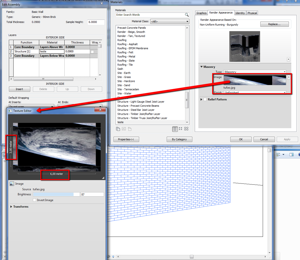

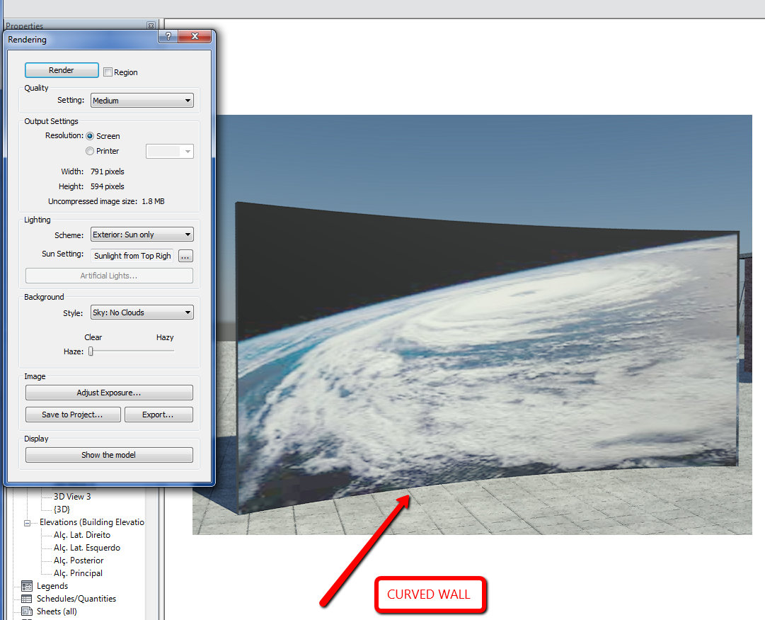

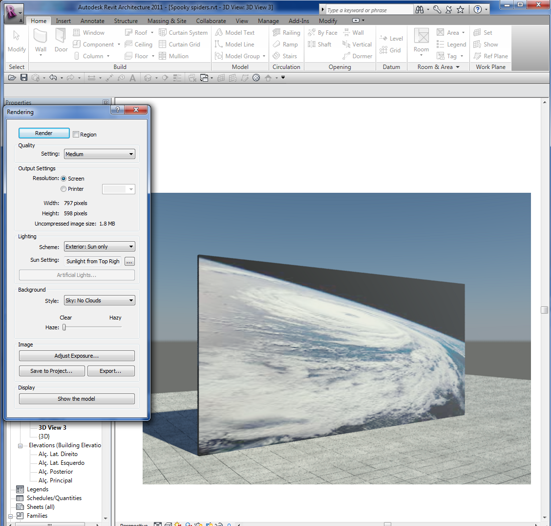

Like you can see in my images just edit that "texture" and change the "Lenght and Height" then you have the effect you want.

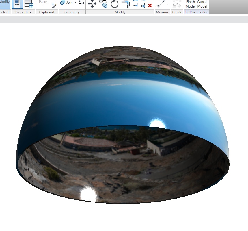

Typhoon, that's an interesting idea -- It immediately made me think of the old technique for putting a background in renderings -- decals on distant walls-- and so I made this horrible monster. I'm not sure what it would do to a project, though the idea of having a panoramic background that's reasonably accurate from any angle is appealing.  The project, of course, would be inside the dome-of-no-sunlight.
It makes me think of the Truman Show.
Also.  the shape of the dome would need a lot of work to match the distortion of the lense, but that could be done.
