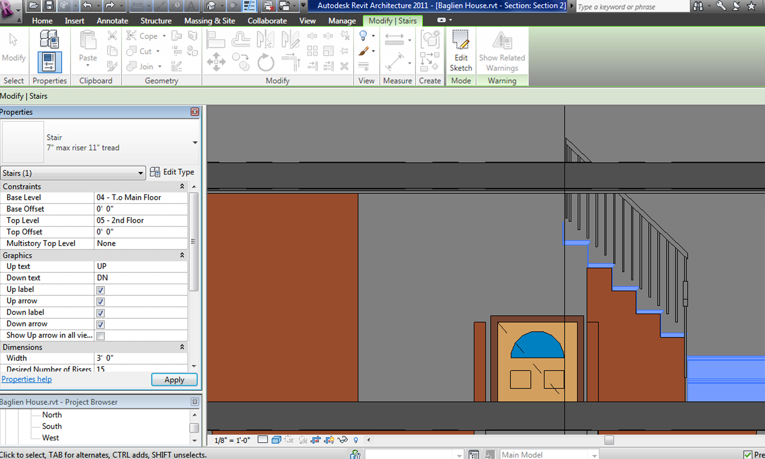

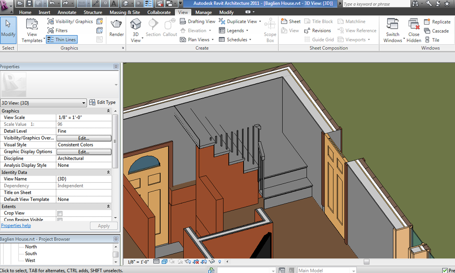

Hi, I'm having issues getting my stairs to connect properly between floors. I have the "start from" and "connect to" set on the correct levels of my model, but, they never reach the top. I've posted two pictures to show you what the basic settings are at, as well as what I'm hoping they will turn out like...
Any help you can offer would be great. This isn't the first time Revit has given me trouble with stairs connecting.

Ensure the desired number of risers matches the actual number of risers drawn in your stair sketch.

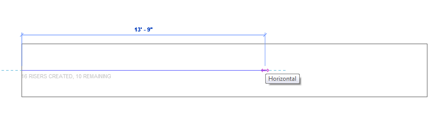

I don't think you're providing enough room for the required number of treads. The stair family has max riser height which controls the number of treads required. Select your stair and hit "edit sketch", does it say 0 risers remaining?
