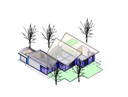

I have the same thing in my first project but not the others. It just changed to transparent in for some reason - obviousl something I did inadvertently. I found it very useful at first because it allowed me to see exactly what was where, but then I found nowhere to 'turn it off'. The model is definitely in 'Shading with edges' and all layers of the the roof material are set at 0 transparency. If you find out what it is, swarch, please let me know.

Post a screenshot...
Wed, Nov 16, 2005 at 4:34:05 AM | RE: transparent roof
Audrie
Joined: Thu, Jul 21, 2005
32 Posts
Okay - here is an 3d Aerial of my Arthouse with this crazy transparent roof... Smile

Are you sure someone hasn't used the paint tool to paint on a different material to the roof that is overrighting the standard settings?

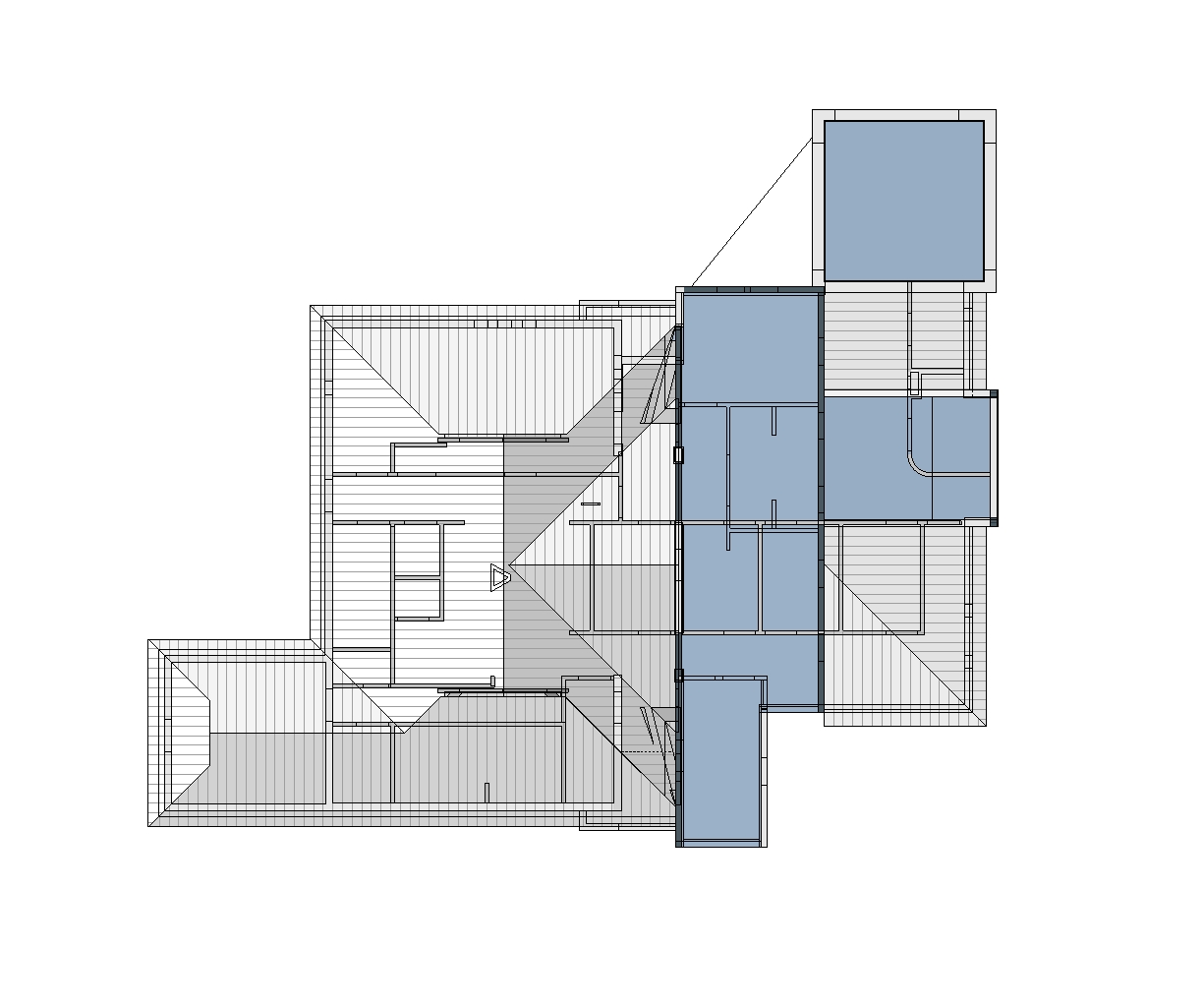

attached is the roof plan. alll other drawings show correctly and i'm in shaded with edges. thoughts?

ok...so the .bmp didn't load, here's a jpg file.

That is normal for transparency of objects. Only 3D views show trasparency in objects. It is definitely to do with the material thats been applied to the roof or painted onto it...

not sure i understand. view is plan, the 3D views show opaque. material transparency is 0. initially the roof was solid in this view and i did not modify the roof type prior to this change. all roof types are now transparent (shingle, generic, metal) and all slopes and phases but initial roofs were solid. thanks for pondering!

it appears to always be in wireframe mode even with the other view options selected....therefore it may not be a "roof" issue but a graphics style issue. what could cause that?
