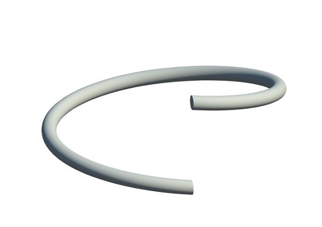

how do i edit a path for a solid sweep
that starts on the first level work plane
and spirals up like a coil spring to higher
levels? something like spiral stairs..
or if i could get model lines that way
maybe i could pick that as a path?
there was once an answer here about "piecing"
together parts of the spring and building it up
or something- but i cannot imagine that..
revit 2011- thanks..

Swept blend.   I would draw a 180 degree arc for you path, and a rectangle for profile one and ground level, 2nd rectangle at X height. rotate and stack these as you please, and then use an outside edge of these objects as the picked 3D edge path of your more complex sweep.
That's just a first instinct idea, by no means the best idea I'm sure.
to expand on this:  It's probably better to do in two steps because it's difficult to account for the disortion of a swept blend between the two profiles.  A sweep is always perpendicular to the path however.  Swept blend profiles are vertical.

posted pic.  easy and fast.  Tip:  sometimes picking a path will give you an error.  Like stairs, shorten it, finish it, re-edit and make it more complex and the program won't complain.
edit:  sorry, images are refusing to upload.
Edited on: Wed, Apr 27, 2011 at 9:46:39 PM

i sure did get this thing tangled up in
my mind before i figured it out..
i guess that's why it's taken me five
years to learn only half of revit.. oh well..
thanks alterego

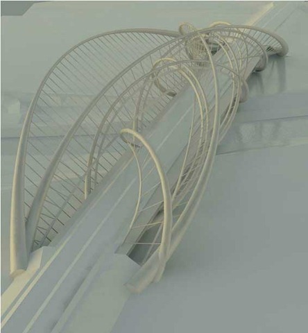

Single and double Helix's have been produced in Revit for sometime.  Here is a quote from Everything Autodesk Revit & BIM  2009 on a competition HOK did:
“The most exciting moment of my design was when time was up, and I transferred all the Parameter information to a nested set of the simple elements. In the click of a button I asked Revit to recalculate over 4500 values, model 1600 solids, regenerate around 20 views, most shaded and shadow-enabled and including perspectives. It took around 3 tense minutes for a quite cryptic image on screen to become the bridge I had in mind.”
....now do that as easily in max
