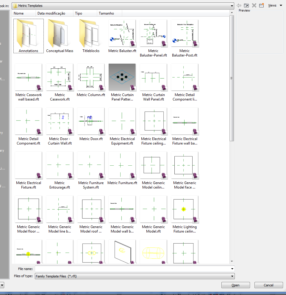

Why you create that with "Conceptual mass" if you want that in a "Furniture" category ????? You have several templates to create your families, do you know that?
Mass families may be loaded into mass families, but not into other families.
You must create THAT family with the right template, in this case I believe is Furniture, right?
